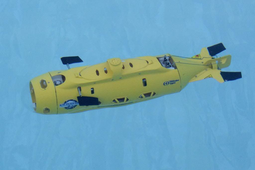

Postby salmon » Tue Feb 25, 2014 5:04 pm
It is a prop that Bob from rc-sub.com put on when he owned it.
here is a photo from his site:
So, should I back this prop off and get a 6 blade prop that TT sells?
User avatar
salmon
Posts: 570
Location: Las Vegas, Nevada
Re: Neptune mod, or late to the party.
Postby Sub culture » Tue Feb 25, 2014 5:12 pm
The scimitar props doesn't make a huge difference. Unless you are unhappy with the speed of the boat, leave the prop as is.
