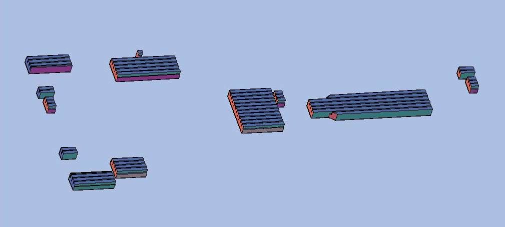

Next I extruded all of the outlines through the deck…
…And subtracted them.
Next I copied the uncut Part 3 template (which I had copied to the side) over the top of the cut one…
…And subtracted the cut one from the uncut one to make the cutouts in 2 easy steps.
I then separated the items and deleted all but the hatches and torpedo loading skid (I forgot to delete the cleat base outline).

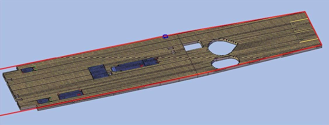

With the detailing work mostly completed, I copied the whole thing to the part.
As with part 2, the deck had to be rotated for alignment due to the slope of the deck. And as before after the wood deck was aligned with the part deck, I moved it up, then lowered it in small increments into the hull subtracting it as I went. The image below shows the deck cutout without the wooden deck in place. Note that the SA’s and cleat bases are high and dry to the cuts I made in the wood deck.
The image below shows the wood deck in place.
The last image shows it joined to the part.
