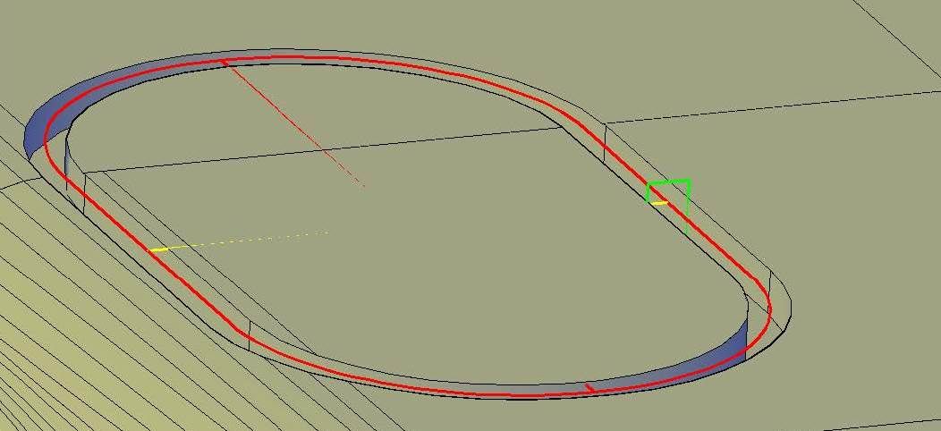

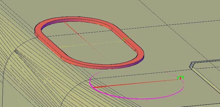

I started with the oval buoy which had to be filled in, which was more difficult than cutting it, due to the fact that the deck isn’t flat.

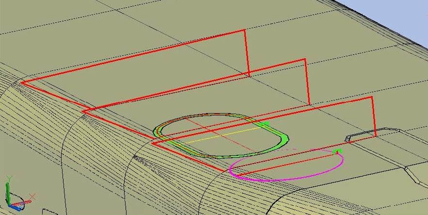

To fill it I slightly enlarged the green rectangle and extruded it around the oval.

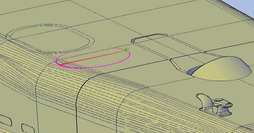

Because the deck isn’t flat, I used three polylines with the lower parts connecting points on the deck.
I then lofted between the polylines…
…Then subtracted it from the extruded oval, leaving the oval pretty much flush with the deck.
I then joined it to the deck. In the image below you can see the difficulty of cutting an object on a curved surface, as you can still see the outline of the oval buoy in Conceptual Visual style. This is because the deck surface and the surface of the extruded polylines wasn’t exactly the same, even though I traced the deck points to make the polylines.

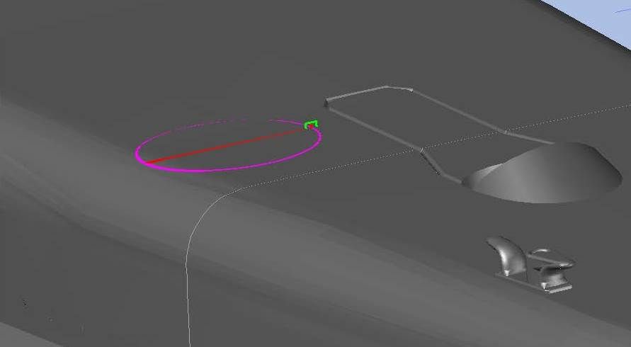

In Realistic Visual style these lines go away and will not show up on the printed part.

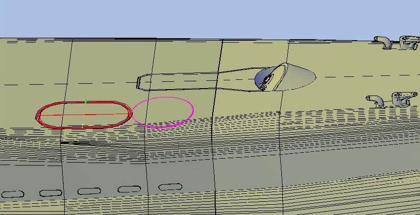

Good Morning Guys, I made a little progress on the model last night and early this morning, continuing on detailing the deck. I started with the forward torpedo loading hatch/skid.

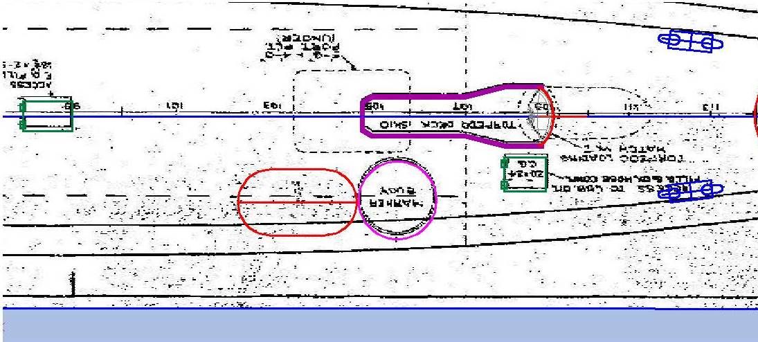

Because of the issue I previously had with the locations of some of my tracings, I went to the plans and retraced them. You can see in the image below that it is a good thing that I did, because the original location of the skid (green) is a good deal forward of the new location (yellow). You can also see that the hatch and trunk are well below the surface of the deck, and therefore do not need to be included on the model…
…So, I concentrated on just the skid.
I did the forward skid in the same manner as I did the aft skid, by drawing a 0.005” radius circle on the polyline outlining the skid…
…Extruded it along the polyline…
…And subtracted it from the deck.
Next, I did the forward messenger buoy, copying the outline and section (green) from the aft buoy forward to the proper location.
I then extruded the section along the outline…

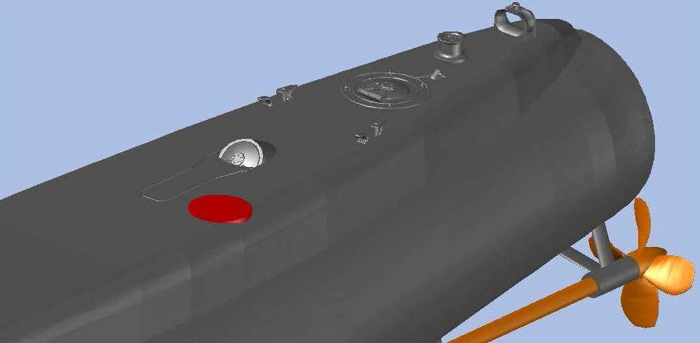

Postby rdutnell » Sat Aug 24, 2013 7:11 pm
UPDATE 99
Thanks Bill and Scott for straightening me out on what the plans call the FPMH, which I assume stands for Forward Plane Man Hole. I corrected it and that process is shown at the end of this post. First though, I added the track seen on Tom’s picture in Post 97 and the access hatch to the wildcat gear. The track isn’t shown on any of the plans, so I suspect it was a modification made some time later, although I don’t know when. I’m not sure exactly what the track is for, but it looks similar to the track on Greenling (SSN-614) so perhaps it too is for safety railing. Is that correct?
In any case, to make it, I started with Tom’s picture and the plans. In the picture, it looks like the track makes a long s-curve then goes straight aft. In the image below you can (barely) see the axis of the track in magenta and one part of the s-curve in blue, as well as the access to the wildcat gear and the “portable plate” seen both in the plans and on Tom’s pic.
I mirrored the s-part about the line moved it to the end and then joined the s-parts and the long straight part to form a single polyline.
Next, I copied the track, the access to the wildcat gear, and two other access panels aft to the model.
Looking at it from the side, you can once again see that the copied lines aren’t parallel with the deck…
…So I rotated them.
Next I drew a rectangle 0.015” wide x 0.02” tall, lowered it half wy into the deck and extruded it along the polyline.
The track overlaps two parts, so I sliced it at the junction point between the parts. In the image below I have colored one light blue for easy visualization.
Next, I drew a 0.005” radius circle on the outline of the portable plate and extruded it along the polyline…
…And subtracted it twice, one for each part. Note that this required copying it to the side and moving it back after subtracting it from the first part.
A 0.005” radius circle was then extruded around the outline of the wildcat gear access hatch.
This extrusion was subtracted from the deck and hinges were made by moving the small rectangles used for their outlines up, extruding them into the deck and filleting their edges.
In the images below, the tracks have been recolored, but I have not attached them to the parts yet.
Of course, the real track is T-shape and a little smaller than what I have. Still, I think the design as I have it is a good replication of it, even if I decide not to use it.
After reading Bill’s and Scott’s posts, I redid the manhole. I started by extruding a circle on one of the posts, copying to the other posts and subtracting them. The image shows this process partially completed.
I then separated the parts and deleted first the cover…
…Then the nuts and bolts. I then extruded the inner smaller oval down into the hull…
…And joined it to the hull, before copying the original MH assembly from the plans.
I rotated it square with the deck, lowered it into the deck and joined it to the part.
CHEERS!!!

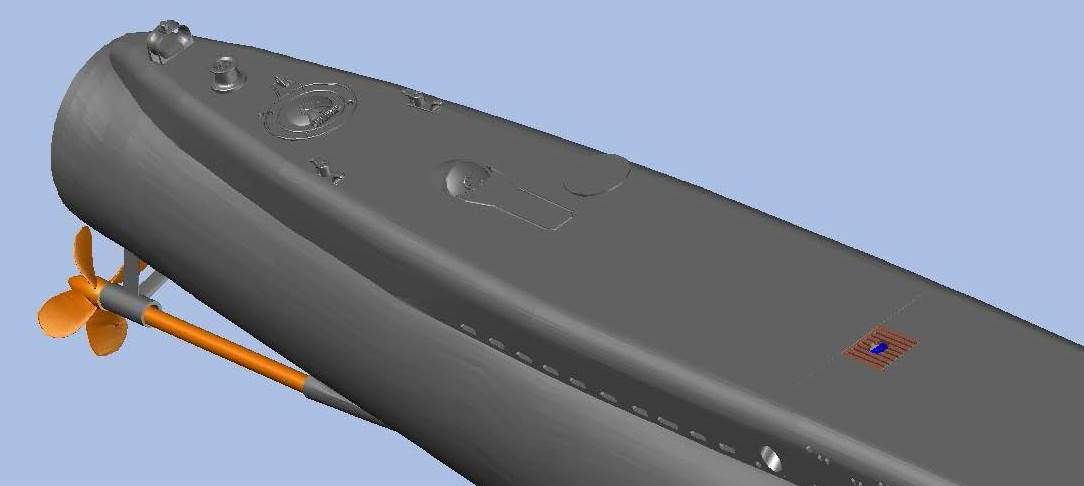

Postby rdutnell » Sun Aug 25, 2013 1:47 pm
UPDATE 100
Good Morning Everybody!
This being the centennial post for my Batfish model, we need to set the mood. In a thread on “Modeling Music” on the odelwarships.com, Tracy posted this. It’s great stuff. Watch it first and celebrate 100!
http://www.youtube.com/watch?v=a-CnWwbe ... r_embedded
OK, now we are ready!

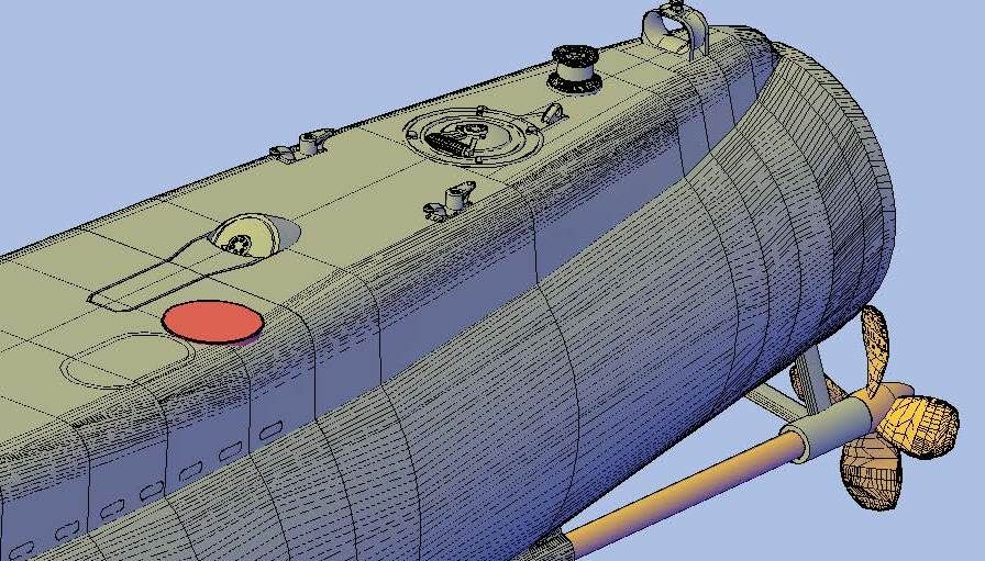

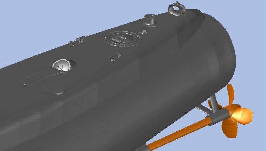

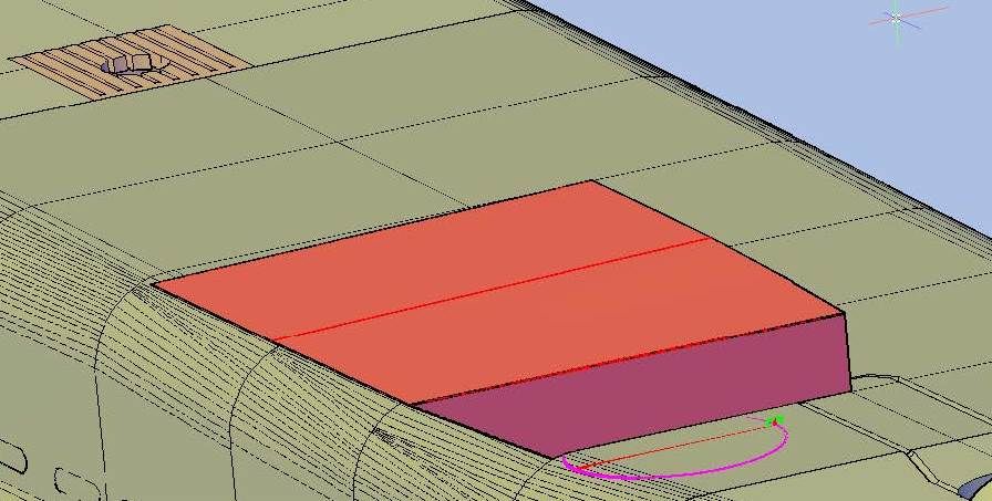

Last night, and early this morning, I started on the wood decking for the main deck. As I so often do, I started by importing the plans into AutoCad and scaling them. The image below shows the plans with my tracings of significant features in red. The lower image shows these tracings copied to the model, and also shows the extent of the wood deck on Batfish in magenta. You can see that the wood deck extends forward past the companionway, where it stops in the plans, to the forward edge of the wildcat access. It also extends well aft of the hatch to the crew’s quarters, as in the plans, all the way back to the aft escape hatch.
That’s the first main difference between the plans and Batfish. The second main difference is that the plans show the 5”/25 gun mount in the forward position. Batfish, currently, does not have a deck gun forward or aft. However, I am considering putting one aft, where Tom D said it was February 10-13, 1945, when Batfish sank the 3 Japanese submarines. The unanswered question remains, “Was the fairweather/bridge/mast configuration, as it is now, on the ship at the same time that the aft deck gun was installed?” If so, great, even if it wasn’t like this in February. If not it would be inconsistent. Still, I’m thinking about adding it anyway. It would be a good talking point for those that know their sh*t, and cool to look at it for those of us that are clueless.
Another difference between my design and the real deal is the cross- section of the battens used to make the deck. The image below shows the detail of the battens, as shown in the plans. You can see that the real ones are 2” x 1-1/2” with a 3/16” chamfer and a 3/4" spacing between battens. At 1/144 scale the battens would be 0.014” x 0.01” with 0.001” chamfers and a spacing of 0.005”, which could probably be printed, but would be too fragile to work with on a model. The mage shows my design for comparison. It is 0.02” x 0.02” with no chamfer (it is just too small) and a spacing of 0.008”, which at real scale would be 2-7/8” square with a 1-5/32” spacing. These dimensions worked out pretty good on the hatch covers, so I thought I would try it for the entire model.
So I copied a slew of the battens side by side using the 0.008” spacing, and then added a base to the battens making the total thickness, from the bottom of the base to the top of the battens 0.05”.
Next, I extruded the battens and the base aft and joined it all together.
The image below shows the extruded deck copied to the side. On the other side are the tracings of the deck both from the plans, and as I added to match Batfish. I have copied the tracings to my deck template. Note that they are referenced to parallel coordinate systems for ease of location.
Here is another image of it after I had trimmed and joined the tracings to form a closed polyline.
Next I copied Part 2 (and a section of the track) to the drawing using the common coordinate system I have on all of my parts.
At this point I sliced the deck template at the aft end of the part, extruded the outline down through the remaining part of the deck…
…And used the Intersect command to make the deck. Note that on the real ship the ends of the battens are cut square (at least they are on Batfish now), and I considered doing that, but the wider battens leave too big of gaps.
I next extruded and subtracted the (open polyline) outline for the forward escape hatch…
…and sliced the deck using the surface just created.
Although I didn’t document it, I next sliced the battens off of the hatch base, rearranged them and widened the inner ones and drew an outline for the handholes (in the wrong location).
I extruded the handhole to the bottom of the battens, moved it, copied it to the other locations seen in Tom’s pic…
…And subtracted them.
Next I extruded outlines of the messenger buoy and companionway through the deck…
…And subtracted them creating the finished “wood” deck for Part 2.
I next copied the completed deck over to the model.
After aligning the wood deck with the model deck, I moved it up out of the way, then copied it down in short increments into the deck, subtracting the wood deck from the part each time.
I then lowered the wood deck into position on the model. The images below show the finished product.
I must say that I am really pleased with the way it came out, although I haven’t joined it to the part yet, in case there is an issue I don’t know about yet. It sure was a lot of fun and I have more to do. Oh Boy!
CHEERS!!!
rdutnell
Registered User
Posts: 388
Location: Norman, Oklahoma
