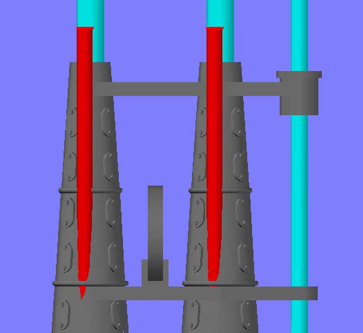

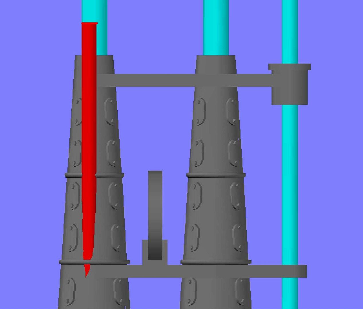

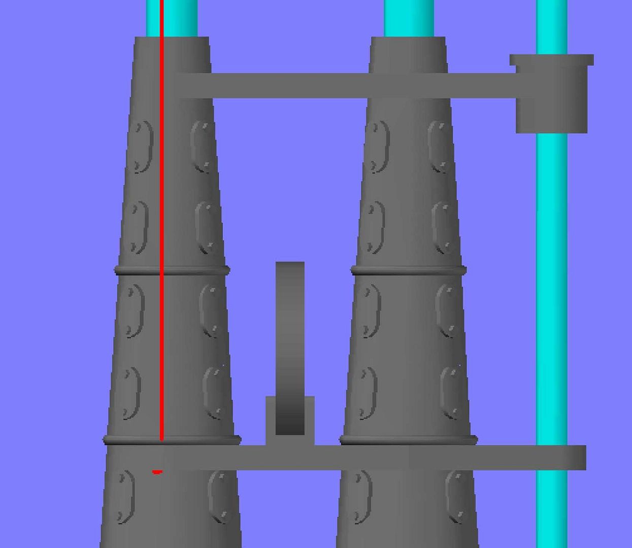

UPDATE 54
I’m having a great time in St. Louis, even though it has been raining and I am not getting to play with Batfish. I have been able to read the posts that everybody has been posting and really appreciate all of the comments you guys have provided, and it seems like we are all learning a bit more about the ship together.
While in Ft. Worth at the Flying Saucer, I posted that the pix Tom posted were “the first pix I recall seeing where the supports extended past the antenna to the new/old ‘SD mast’". The beer must have taken effect, because I had seen this before and had decided to use the newer configuration.
Ronald, you are perhaps right. It may indeed be that my model has more detail than can be printed, even though I am designing it so that nothing is smaller than 0.05” in diameter because that is the limit my buddy said that his SLA can print. I really have no clue, though, how it will print, and like you, am curious how it will come out.
Besides learning that the items I was asking about are the telescope hoist cylinders, I also learned that the last item I made and posted was the “DF Loop”. After completing the DF Loop, and before I left on my trio, I also finished the telescope hoist cylinders. My buddy is taking a nap, so I thought I would post the process I used to make them.

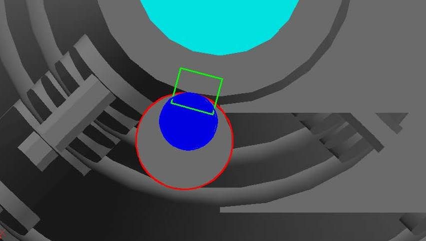

I started by drawing a vertical line at the location of the cylinder on the forward mast.
I then drew a 0.34’ (0.028” at 1/144 scale) diameter circle and extruded it down into the shear.
Then copied it to the aft shear…
…And subtracted them from the shears.
Having cut the recesses for the cylinders, I then made the cylinders themselves using an extruded 0.2’ (0.0167” at 1/144 scale) diameter circles.
The alignment of the cylinders relative to the recess can be seen in the top view image below. The green rectangle was also extruded to provide support for the cylinder.
Although it is slightly visible, it will not be apparent to most observers and will provide much needed support for the cylinder. This support was copied to the other shear as well.

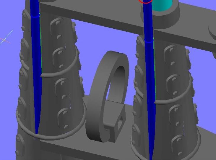

At this point I added the support brackets seen at the top…
…And made the parts for the top caps.
I then attached everything to the shears and recolored it.
Once again, I don’t think it is perfect, but I think it is a fair representation of the real deal.

Postby Scott T » Sat May 04, 2013 8:22 pm
Looks great! I believe there are also tubes on the starboard side of the shear as I think you can see the lower end of a tube going into the shear on this photo.
It would be parallel with the other tube on the port side with a centerline throught the center of the tube and center of the periscope.
So it will be two hydraulic cylinders pulling up on each side of the periscope evenly.

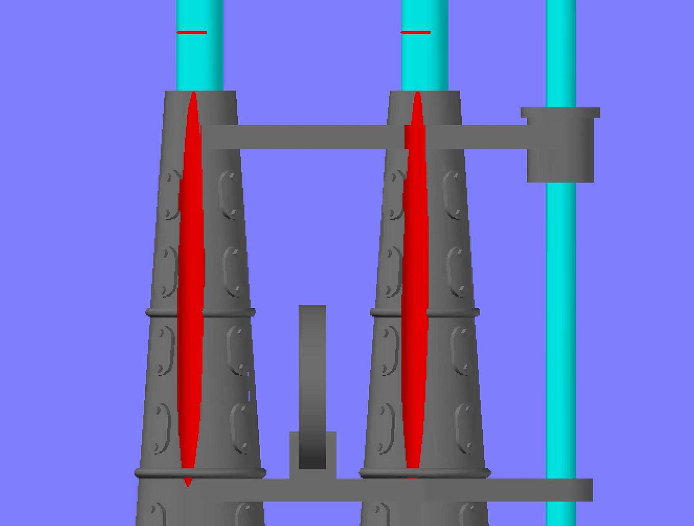

Postby rdutnell » Mon May 06, 2013 2:28 am
UPDATE 55
Happy Cinco de Mayo Everybody! (O>K>, officially Seiz de Mayo.)

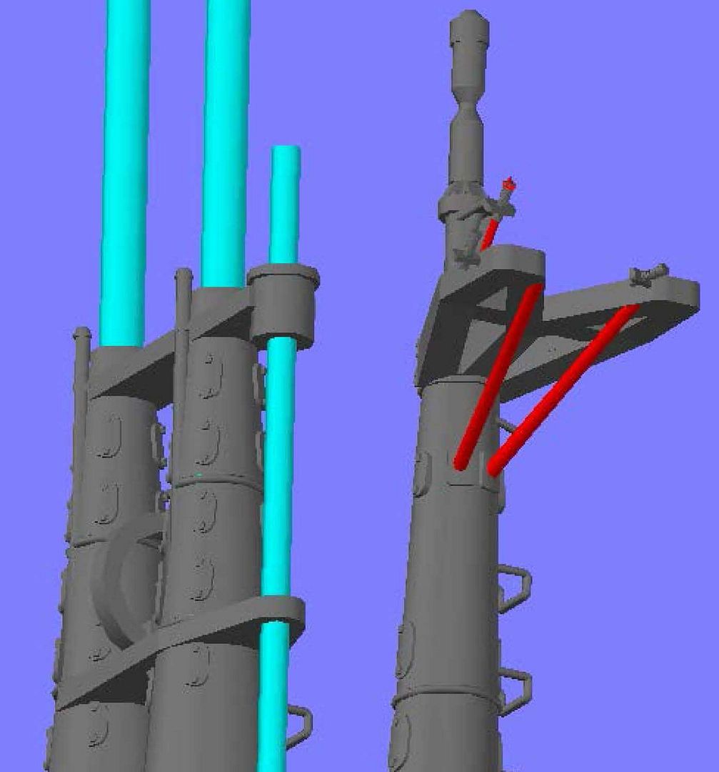

With everyone asleep again, I continued on with the periscope shears, next adding the flanges at the top of the shears. I started with an extruded circle…
…Then used a triangle to make one flange…
…And copied it around the top of the shear.
Because the two tops appear to be the same, I copied it to the other shear.
At this point, I read Scott’s post pointing out that the telescope hoist cylinders were on the starboard side as well as the port side. There are several ways that I could have accomplished this, but I decided, because of the symmetry to do it by dicing and slicing. The image below shows the cut lines I used to accomplish this with the section I replaced cut out.
The section with the cylinders was then rotate/copied to the opposite side.
The aft shear was sliced in a similar fashion…
At this point I made the platform on the forward face of the forward shear, and even though I think that the “cage” will be made out of photo etch. I made it too.
I also made the platform to support whatever sensor that is at the front.
Cheers!!!

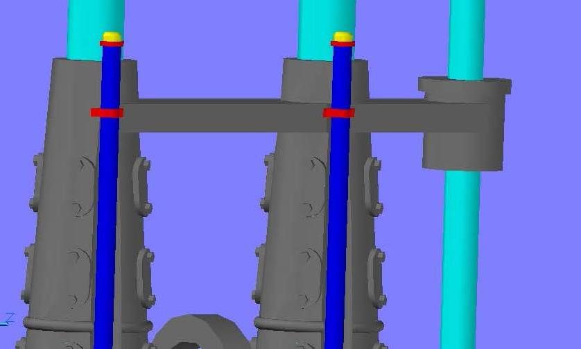

Postby Scott T » Mon May 06, 2013 1:36 pm
Man that really looks good.
Pick time. Looking at the picture if the bottom cylinder is at 7 o'clock the top cylinder should be at 1 o'clock. :wink:
This would makes both cylinders on the same centerline of the periscope. I think the way it is drawn now would put a side
force on the scope and not lift with even force.

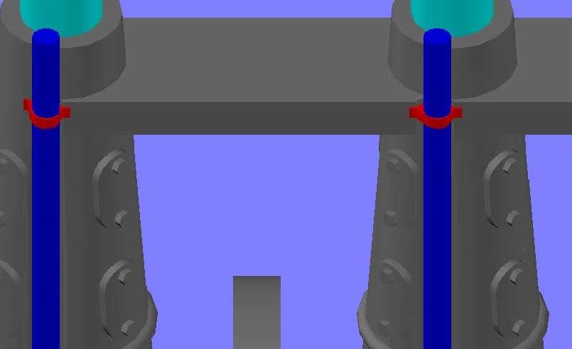

Postby rdutnell » Sat May 11, 2013 2:02 am
UPDATE 56
That makes sense to me Bill. I think I recall reading that Batfish went in for overhaul in ’45, prior to sinking the 3 Japanese submarines in 76 hours that she is most famous for.

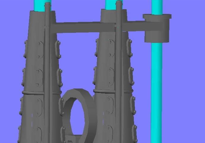

And thanks again Scott for both the nice words and the picking. If I had thought it about it a little more, looked at your pictures closer, or read your previous post more carefully, this particular pick wouldn’t have been needed. I guess that is what I get for being impatient and staying up late to play with it.
Anyway, I’m back home and after a busy week I finally had some time to redo the hoist cylinders. The symmetry that made doing it wrong so easy wasn’t there to do it right, so I essentially had to remake them, as I did on the port side. Before I did anything else, I had to slice the incorrect cylinders out, so I drew the by now familiar slice lines
I sliced out the unwanted cylinder, and using a slice from the “pre-cylinder” version of the drawing I have repaired the slice to its pre-cylinder condition.
I then turned on the 0-misc layer and rotate/copied the circles and polylines I used to create the cylinder on the port side 180 degrees to the opposite side of the shear…
…Then copied them to the other shear.
I then extruded the circles for the cylinder recess…
…And subtracted them.
Next I extruded the cylinders (along with the back supports)…
…And made the collars and caps.
Then I reshaped the support brackets and extruded them.
The last step was to join everything together.
CHEERS!!!
