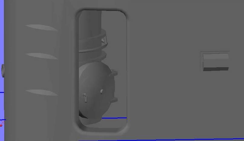

Postby Scott T » Tue Apr 16, 2013 1:14 pm
Hey let me confuse things a little more. :D
I believe the two things you see throught the door opening on the fairwater are the conning tower with the scopes and hatches to the outside deck
and the lower main deck, The other cylinder with the door on its side is a escape trunk. Attached is a diagram of the escape trunk for one of the
bow hatch. The fairwater hatch has a hatch on top which ammo/other can be passed through. It has a hatch on the side for escape and a hatch on
the bottom to enter from the main deck. If escape is necessary you enter the trunk and seal the bottom hatch, you flood the chamber and exit
through the side door. You can see the stick figures with their head in a air bubble. Hope I got this right.
Edit: The ridges in the front face of the fairwater are strengthening gussets that circle the escape trunk and stick through the skin of the fairwater
covering. See Tom's picture below for the gussets.
http://www.maritime.org/tech/escape.htm Escape procedures.

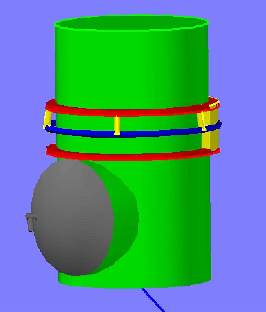

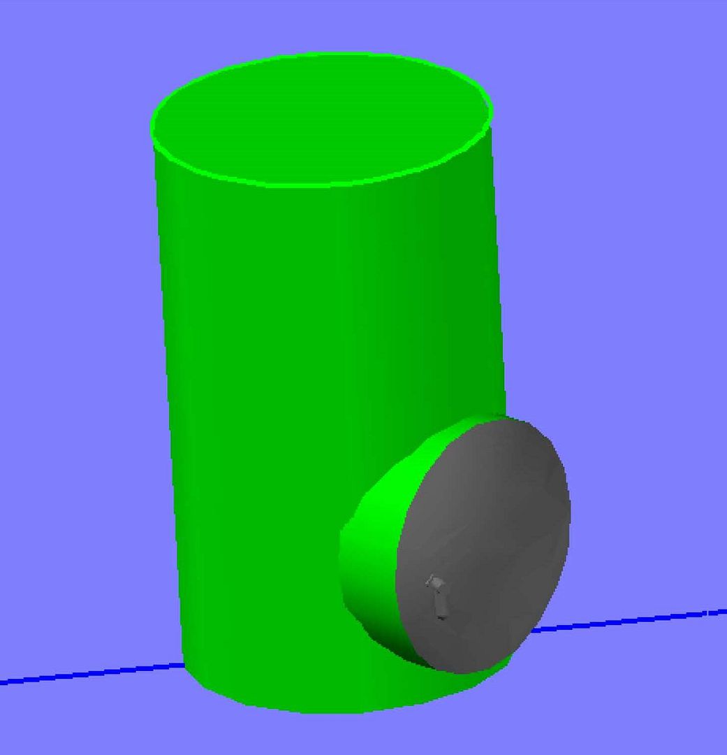

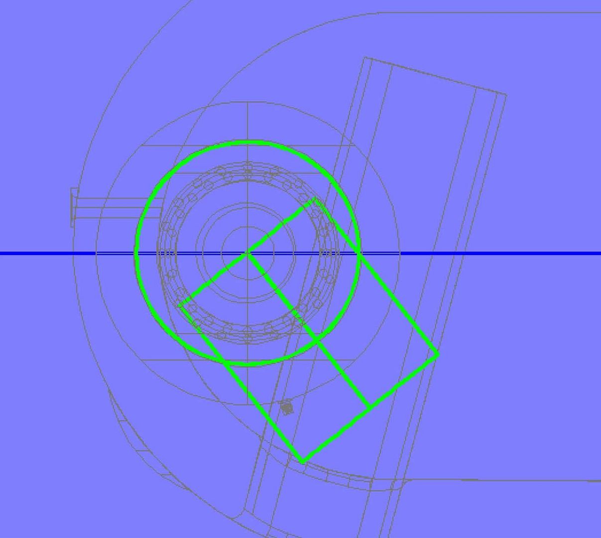

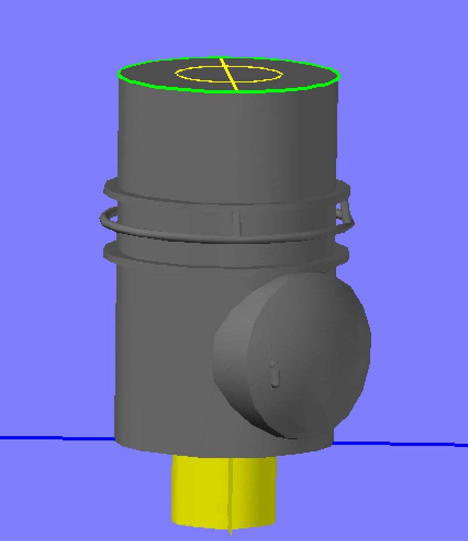

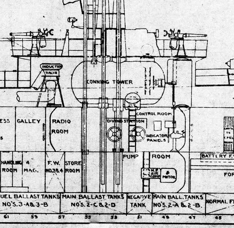

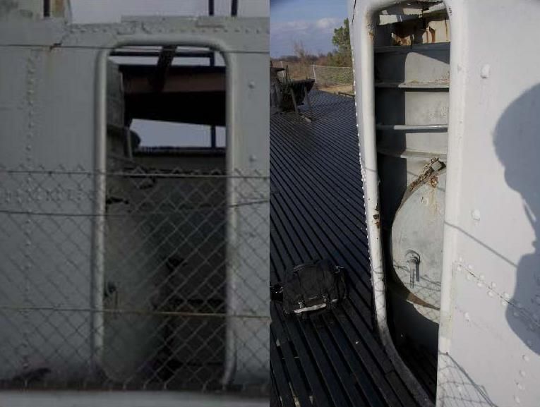

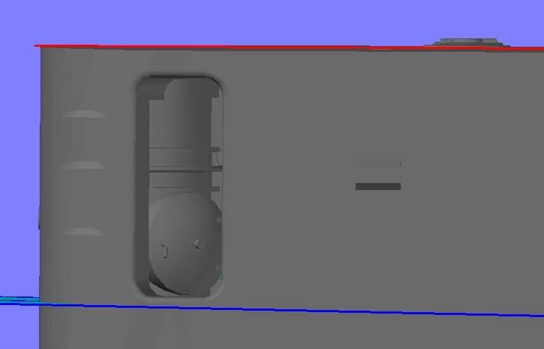

Postby rdutnell » Wed Apr 17, 2013 12:07 am

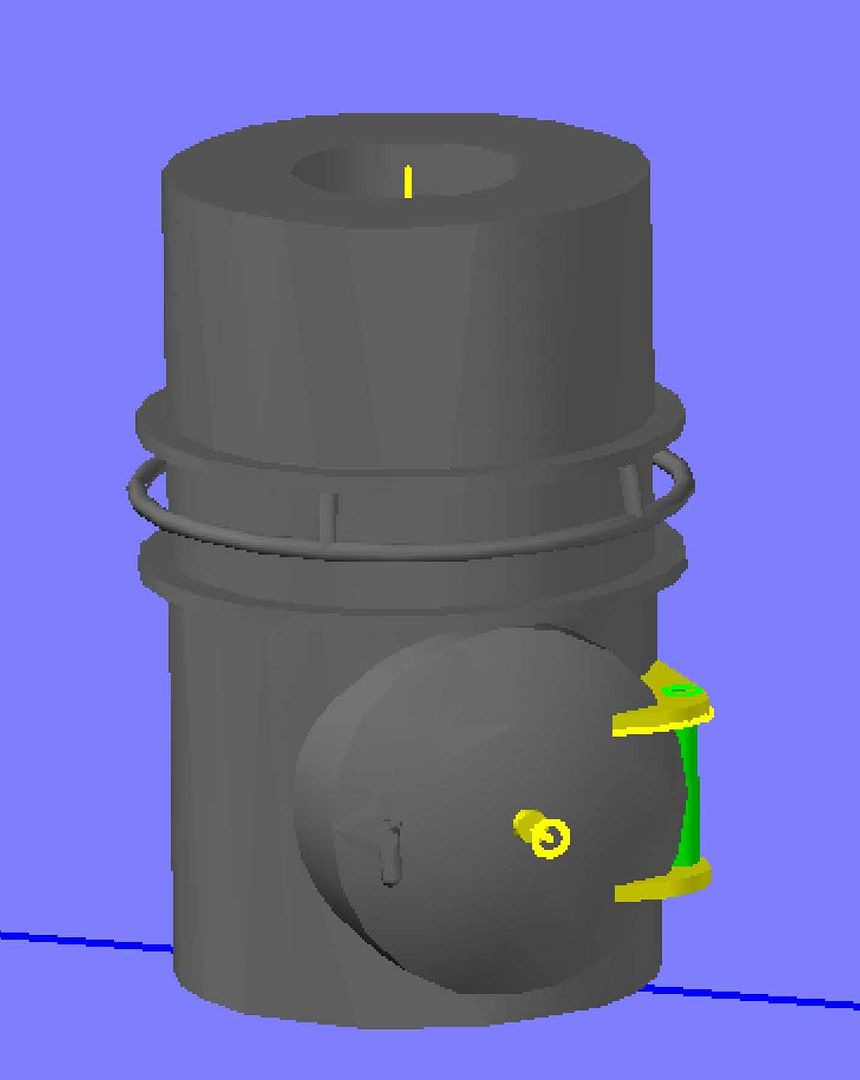

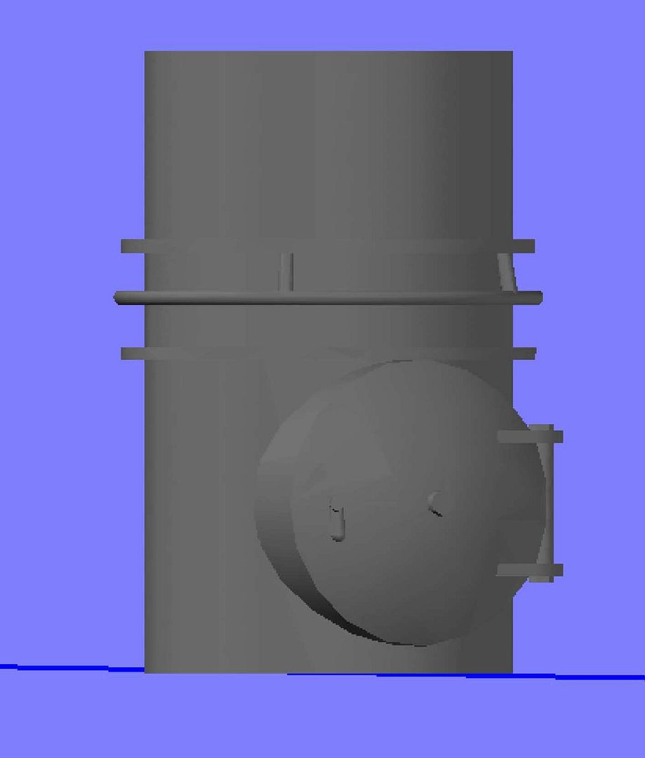

UPDATE 36
Thanks Scott! Actually you un-confused things nicely, even if the guys were on tight rations as Sub culture said. :o)
Between your info and Tom’s, and another look at Page 4 of the Booklet of General Plans, I think I finally have it figured out. Below is a clipped image of said Page 4. You can see that the conning tower is clearly marked. You can also see the gun access trunk, with hatches top and bottom, and the door is also visible, partially behind the trunk. Control mechanisms appear to exit the conning tower, and seemingly enter the gun trunk and proceed down to the control room. The image seems to confirm what wlambing posted about the trunk being solely designed for gun access, even if the plans are for SS381 (USS Sand Lance).
The image below shows two familiar images presented together. In Tom’s picture you can see the part of Tom D.’s picture shown in red. The flange, I assume, is where the control mechanisms would have exited the conning tower before either entering the gun trunk or paralleling it before going down to the control room.
[URL=http://s1352.photobucket.com/user/rdutnell/media/USS%20Batfish%20ACAD%20images/pix36_Page_01_zpsc1aa7ca0.jpg.html][IMG]
http://i1352.photobucket.com/albums/q65 ... aa7ca0.jpg[/IMG][/URL]
Two more familiar pictures from Tom (one also posted by Scott) show the gun trunk sufficiently I think to redo the design. The trunk is cylindrical with two support gussets and what looks to be a circular steel rod attached to the underside of the upper gusset by a straight steel rod. The hatch too is cylindrical with a round hatch.
So here we go again...

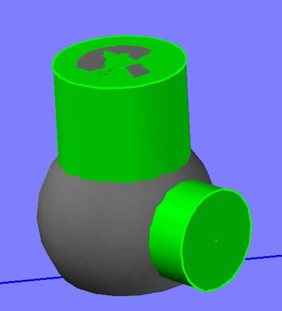

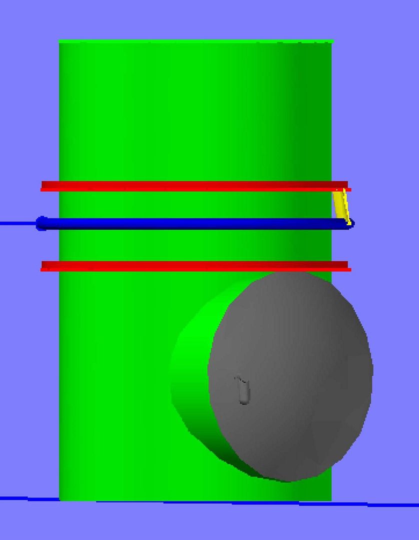

I started the new trunk over the copied old one, starting with a vertical cylinder.
Next I prepared for the hatch, by drawing a circle on the correct alignment.
I then rotated the circle and extruded it into the old trunk.
At this point I decided to take advantage of the existing trunk, and did a union with it and the newly created hatch tube.
I then added the lower support gusset by drawing a circle and extruding it.
This gusset was then copied up to create the upper one.
I next prepared for the round rod that appears in the picture, drawing a small circle tangent to the larger circle.
This small circle was then extruded using the large circle as the path.
Next I added the support rod seen in the pictures.
I then added a couple of more that would be visible and blocked off the backside that won’t be visible.
At this point, I joined everything together and prepared to hollow it out…
…By subtracting the smaller diameter cylinder.
I then added the round feature on the front of the hatch and prepared to make the hatch hinges.
The image below shows the hatch hinge under construction. The arms have been extruded and the shaft has been added, and I’m preparing to make the ends which I made out of hexagons.
Here is the finished trunk…
…Which was then copied to the fairwater.

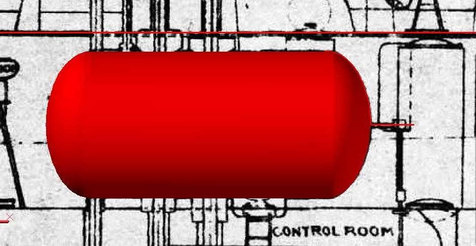

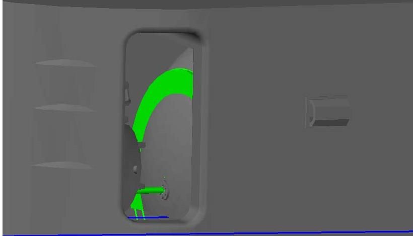

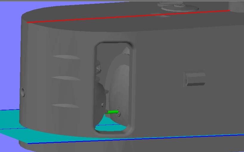

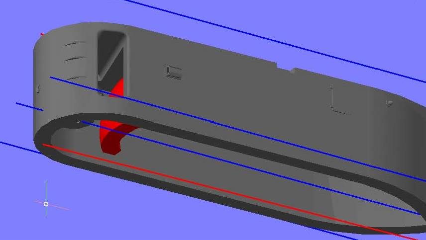

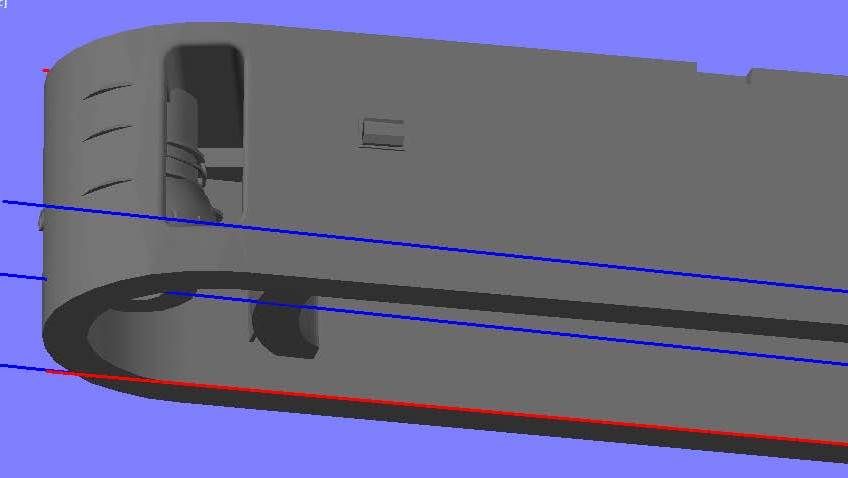

At this point I switched my attention to the conning tower, starting by copying the Page 4 clipping into AutoCad and scaling it, which I then first drew a cylinder on…
…Then added the ends and joined the 3 pieces into 1.
Next, I copied the completed conning tower to the fairwater model, using the forward edge of the fairwater as the reference point.
Obviously I don’t need the entire conning tower, so I used the shell command to create walls 1.125’ (3/32” at 1/144 scale) thick, and sliced off the parts I didn’t need, first slicing off the bottom at the deck level…
…Then slicing everything aft of where it entered the fairwater sides (due to them being unrealistically thick).
Next, I added the flange in the lower middle, the conduit for the control mechanisms, and a gusset.
I then joined everything except the conduit, because, I’m not sure that I should include it. What do you think? Yay or Nay?
I haven’t decided if I want to add the bracket seen at the top of the pictures of the conning tower through the door. It looks pretty good (though not perfect) the way it is, so I’m tempted to just leave it the way it is. I can always add it later if I change my mind, just as I can join the conduit if I decide to keep it.

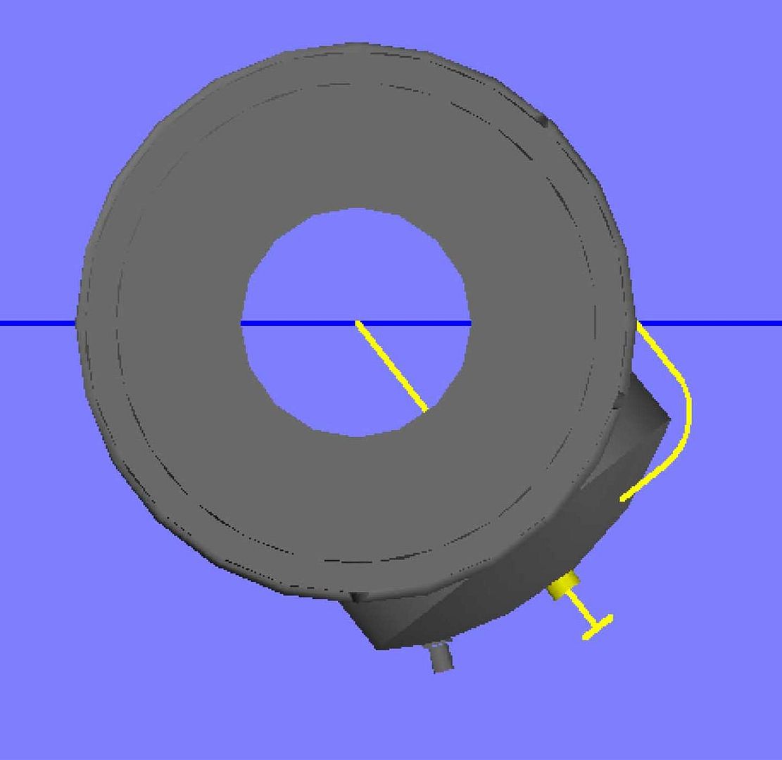

With the support bracket completed, I turned my attention to the pig stick itself, starting with drawing the center line along the outer edge of the bracket. I then realigned my coordinate system and drew a circle with a diameter of 0.14’ (0.12” at 1/144 scale)…
…And rotated it 90 degrees. I also moved it down to make sure that it was in the mast.
Next I prepared to drill a hole through it by drawing a 0.06’ (0.005” at 1/144 scale) diameter circle…
..And extruding it.
I then subtracted the smaller cylinder from the larger one.
I think it came out pretty good, but I don’t think, at 0.005” diameter, that you could put a staff with a flag on it in the hole. So, I looked at my spare plastic and the smallest rod I found was 0.025” (0.3’ at 1/144 scale), so I did a redesign with the ID at 0.3’.
As you can see, when I make it big enough to hold a flag, it overwhelms the structure. So, I think that the flag is out.
