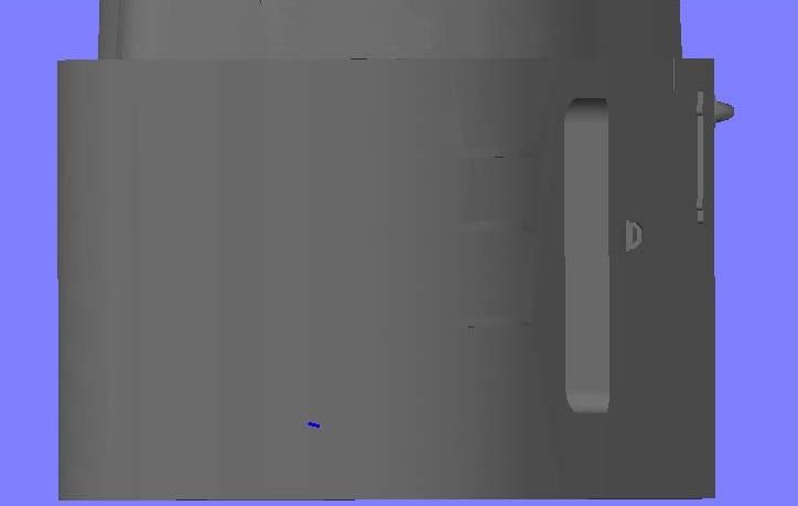

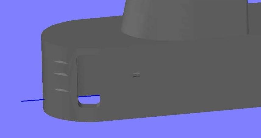

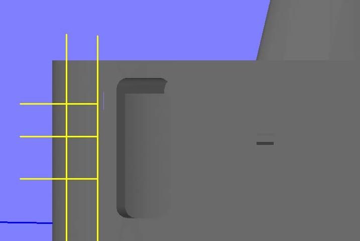

The limber holes above the torpedo openings can see through to the other side.
Place a floor shape below them so you can't see into the torpedo openings.
This has probably been taken care of by how you formed the torpedo door area.
The other limber holes should be sight blocked. By attaching a wall vertical from the underside of the
deck it could be blocked. This would form a T-shape with the deck as the top.

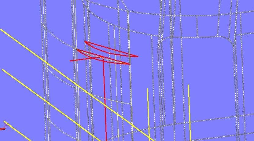

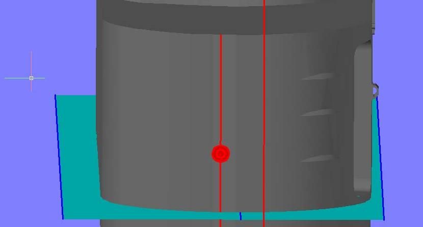

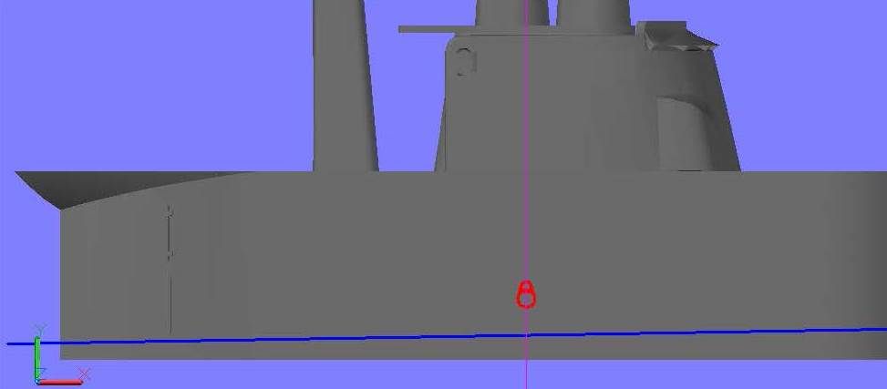

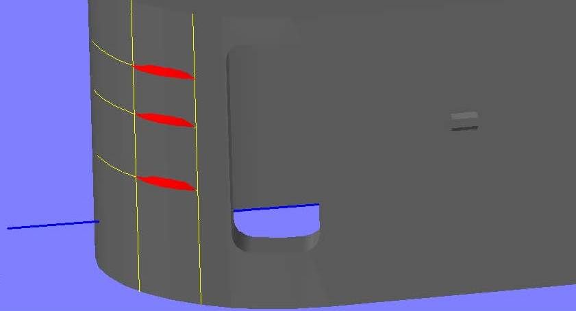

I fixed the limber hole problem, using the plans to do it. The image below shows a porrtion of the “Body Plan Outer Hull” plan sheet, with my frame tracings. The plans also show the pressure hull outline, so I simply created small wedges at a few sections by tracing the plan lines. I started with Part 2, because Part 1 didn’t need it.
After I made the wedges, I copied them to the correct locations…
…And rotated them 90 degrees.
Before lofting the sections, I scaled them to 95% so they wouldn’t protrude from the sides. In the image below you can see what I mean. Even with it scaled 95%, I had to change the loft setting from smooth to ruled to prevent the protrusion. I then copied the sections down, out of the way, scaled them again, this time at80%, and lofted them
I then moved the lower shape up into position and subtracted it.
The resulting arc shape was sliced off and then joined to the hull.

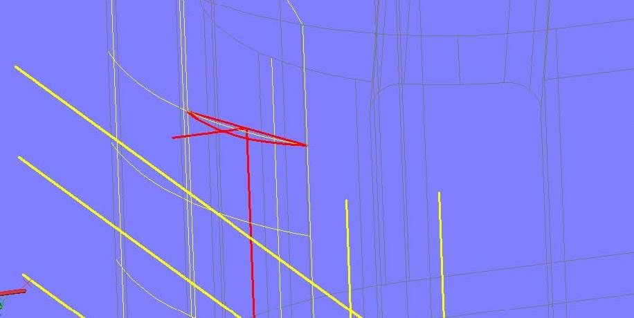

For Part 3 I first copied the aft two shapes from Part 2 onto the drawing, then repeated the process described above for 3 additional sections.
Parts 4-7 were easy since they were straight. Each time I copied the aft section shapes from the preceding part and copied it the forward edge of the part I was working on.
Rather than working “in the model”, I did the lofting and subtracting below. I also trimmed the bottom of the shape so they wouldn’t extend down as far. This gave better mating with the hull on the inside.
I then moved them and joined them. Part 8, the last part modified, required tracing a couple of extra frame sections but other than that it was the same process. The resulting parts are shown below.

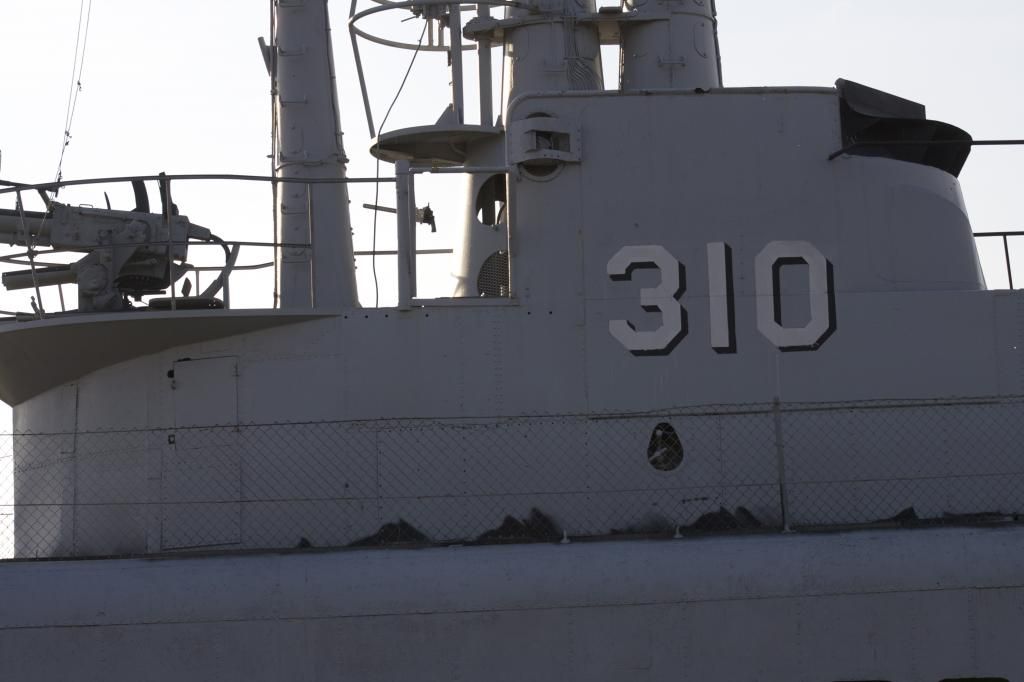

Postby rdutnell » Thu Apr 11, 2013 11:09 pm
Good Evening Everybody!
I’ve been looking at numerous pictures trying to decide what to do next and in the process I found another cool picture, on Tom’s Photobucket site (Again, AWESOME STUFF Tom!). It shows the aft end of the fairwater. What makes it cool is that it looks like you can see a progression of the shape. It looks like it may have started with the jog shape that is shown on the Pampanito plans, as you can see what looks like what may be a seam. Then it looks like they filled in the notch. You can even see the rounded edge from this mod. Finally, they extended it what looks to be a foot or so. Pretty cool stuff!
I also have a question regarding the picture. The opening below the SD mast looks to be a hatch minus the hatch. Is that correct?

Postby salmon » Thu Apr 11, 2013 11:32 pm
Yes, missing hatch door. Not sure the status of it.

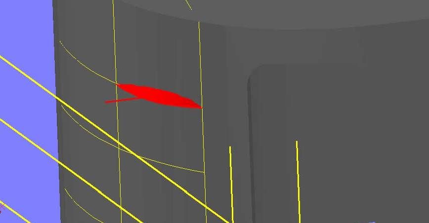

UPDATE 30
Greetings All!
Tom, when I finally get over to see Batfish, I will have to check on the missing hatch door. If I find anything out I will let you know. I had the same thoughts about the book when I received it, and I’m a wee bit past 13.

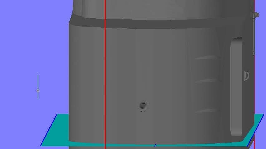

Using the photo from my last post and the one below, I decided to make what I at first glance thought was a light, but now I don’t know what the heck is.
Whatever it is, I made it and here’s how I did it…

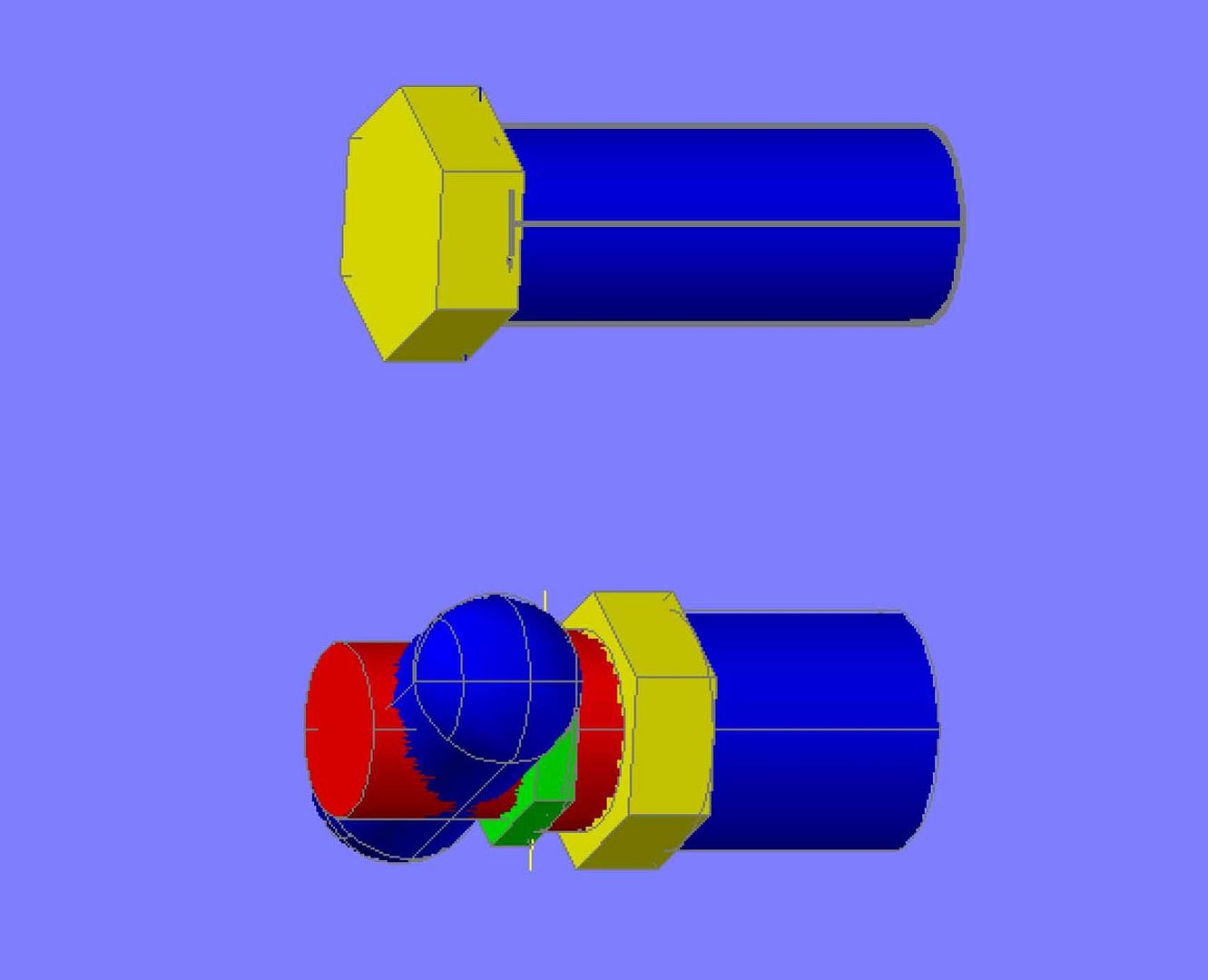

I started in profile view (or elevation for you architectural types) trying to get the sizing and locations of both the unknown (to me) object and the hatch opening more or less correct, as best I could from the pictures.
The unknown knob object was created using circles lines and an arc. The small circle on top in the image below has a radius of 0.06’, which at 1/144 scale is 0.005”, the limit of the SLA that will hopefully one day print this model. It is not possible to print the hole in the end, as shown in the pictures, so I didn’t include it.
At this point lofted between the lower circles and revolved the arc around the center axis. I made the base longer than it needed to be, so I added another circle (blue) at 0.06’, as a guide when I attach it to the bridge bulkhead.
Next, I used the projectgeometry command to project a circle onto the bulkhead and drew lines between the quadrants.
The reason for the lines may be seen in the next image. The object has been moved to the center of the crossing lines and you can see in the image, which has been rotated for easier visualization, that the object is skewed relative to the bulkhead surface.
So I rotated it using the lines I drew earlier.
The end result looks pretty good I think.
I turned my attention next to the access hatch.
Tom’s awesome photo collection of Batfish also includes good shots of the starboard side of the bridge, and the image below, that I have cropped, you can see another hatch/plate/door/cover(?) that appears to be the same as the one on the port side. I assumed that it was, and rather than cut a hole as in the museum display, where Tom took the pix, I opted to turn it into a 0.06’ plate protruding from the bulkhead. Although I failed to document the process, I lofted the outline probably about 0.01’ and then stuck it into the bulkhead so that 0.06’ was protruding.
More will likely follow shortly, as I am on a roll. Who needs sleep?

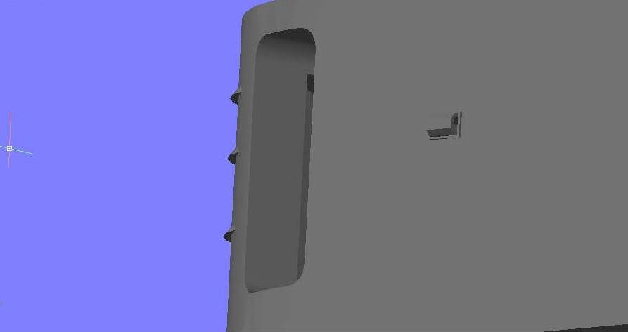

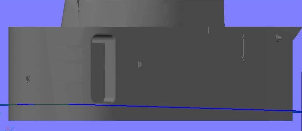

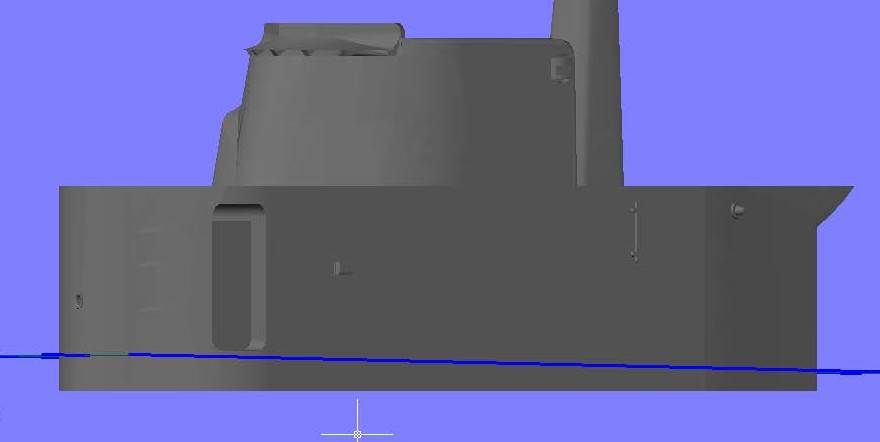

Continuing on the bridge, I used Tom’s great photos again to make the gun access hatch and whatever that object aft is. Below is the main picture I used for the design. It has been cropped from the original.
Like always, I started by drawing the outlines of the two objects, and positioning them as best I could from pictures.
I started with the unknown object, drawing the lines I needed to make the desired shape.
I then lofted the base (green) and the outer part of object (yellow)…
…And lofted the yellow part to create the opening seen in the pictures.
Next, I used the projectgeometry command to project the outline onto the bridge bulkhead…
...Prepared the object for moving by drawing my guidelines…
…And moved it into position. Note the yellow, vertical guide line is just at the surface of the bulkhead.
I then joined it to the bridge. I thought I was finished at this point.
Later, I decided to cut a hole through the bulkhead, because it seems that is what the unknown object does in the pictures I have.
I started by copying the top rectangle down to the base, and changing the color to yellow for easier viewing.
I then stretched the new rectangle to match the interior edges of the object on the base plate, extruded it …
…And subtracted it.
At this point, I shifted my attention to the gun access hatch, beginning with using the project geometry command to project the hatch onto the bulkhead.
I then moved the shape onto the surface and rotated so that it was aligned properly…
…Lofted it through the bulkhead…
…And subtracted it.
At this point I wasn’t sure what the hatches looked like during action. In the museum, it is open, as it is in a picture I have of Balaos “Bridge Up” Memorial (wherever it is). Some pictures I have seen of Lionfish also are open with rounded edges. But, I am not sure if this, so I made a copy and rounded the edges on one and left them on the other. The images below show the hatch with rounded edges.
Since I am unsure if the hatch was open or closed I will do future work on the one without the rounded edges, as this will allow me to add a hatch door or round the edges when I learn more.

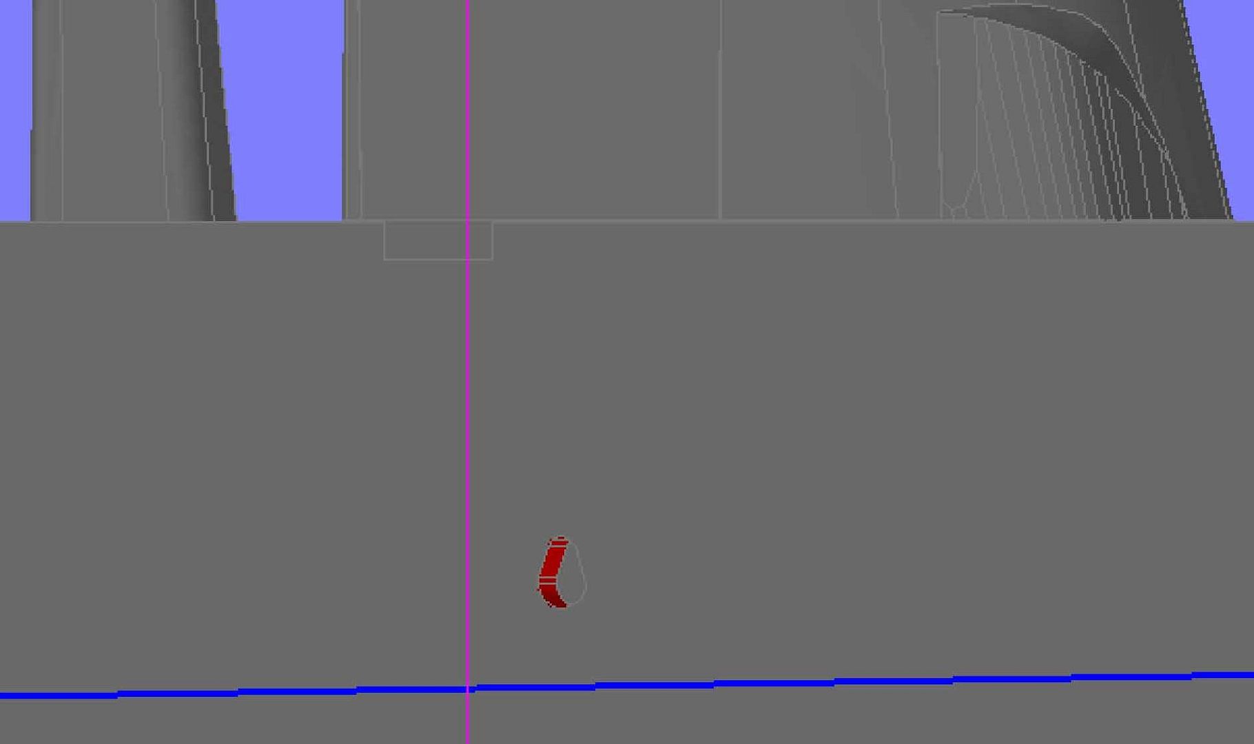

Whatever the case, I continued on the bridge/fairwater bulkhead detailing, next adding more unknown (to me) objects that appear to be vents of some sort. Whatever they are, they are located just forward of the hatch on the port side, as can be seen in the first picture in Update 32.

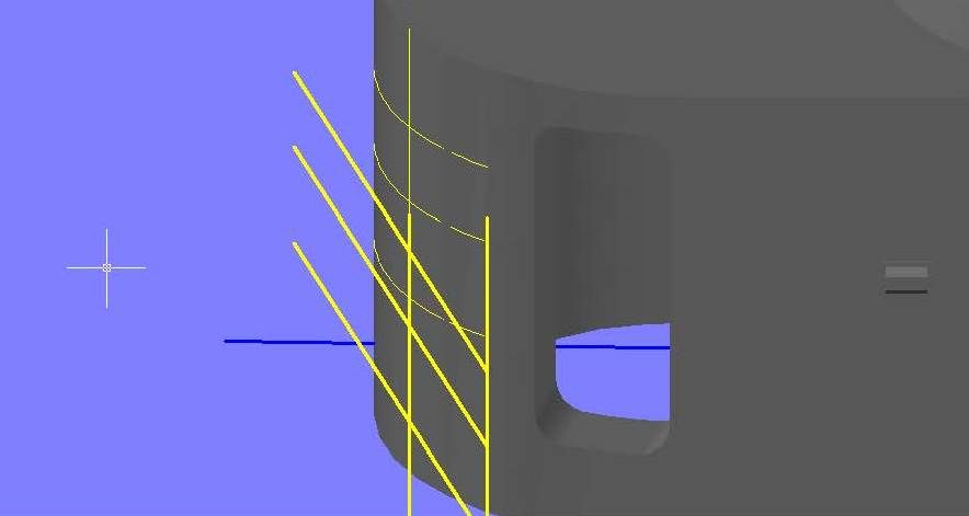

I started by drawing construction lines showing where the features are located.
I then used the projectgeometry command to project these guidelines on to the curve surface of the bulkhead.
I then drew an arc on the top projected guideline, connected the ends with a line and joined them to form a polyline…
…Which I then copied in and up…
…And lofted them.
Next, I copied the lofted shape to the other locations the object is seen to be in photographs…
…And joined them to the bulkhead.

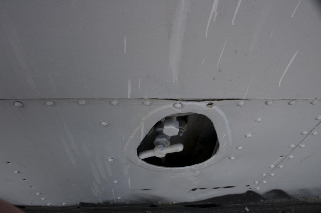

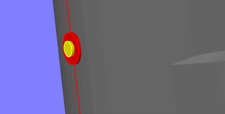

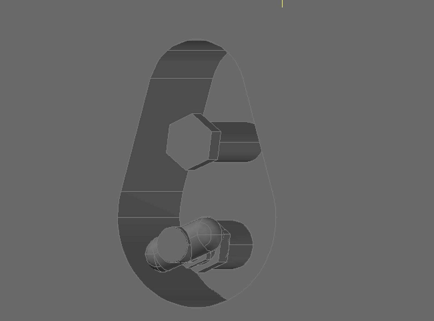

Next I prepare to add another unknown (to me) detail, the hole in the front of the bridge or fairwater bulkhead. This involved drawing two concentric circles at the correct location…
…And extruding the circles.
I then subtracted the inner yellow circle shape from both the red circle shape and the bulkhead and filleted the edge of the inside circle to match the shape seen in pictures.
It was about this time that I read Tom’s post and rounded the hatch edges. They are rounded with a radius of 0.16’. I wanted to round them more (i.e., increase the radius) but AutoCad wouldn’t do it any larger. It can always be sanded by hand if it looks like it needs it when the model is printed.

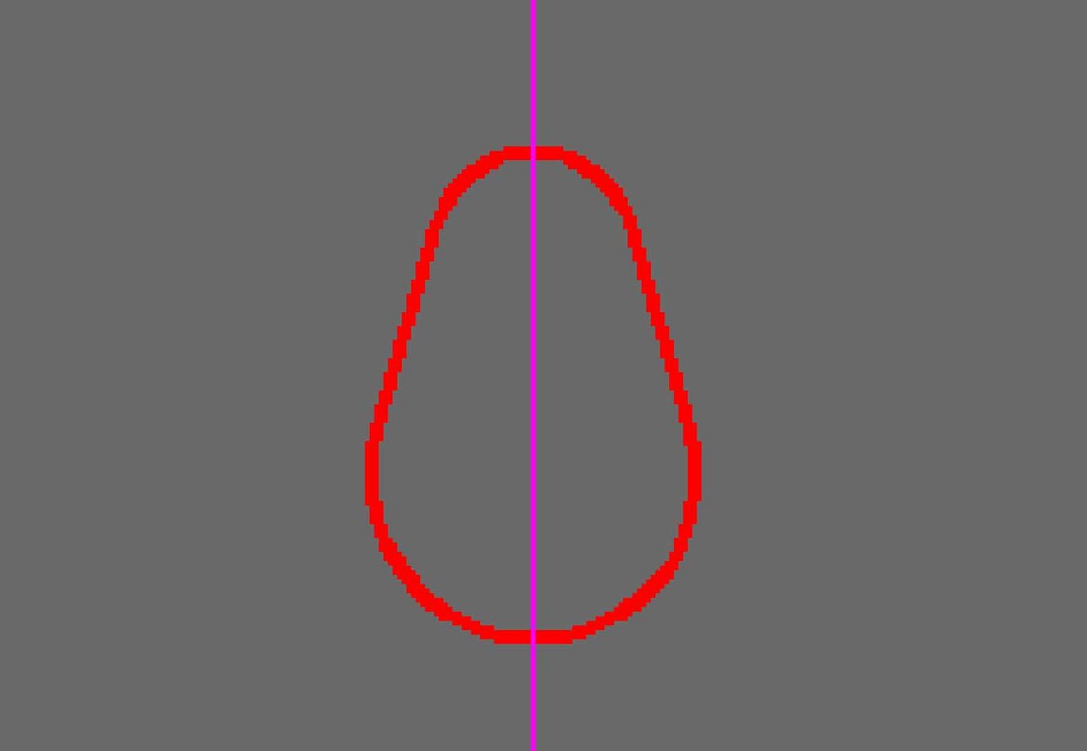

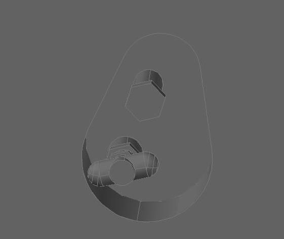

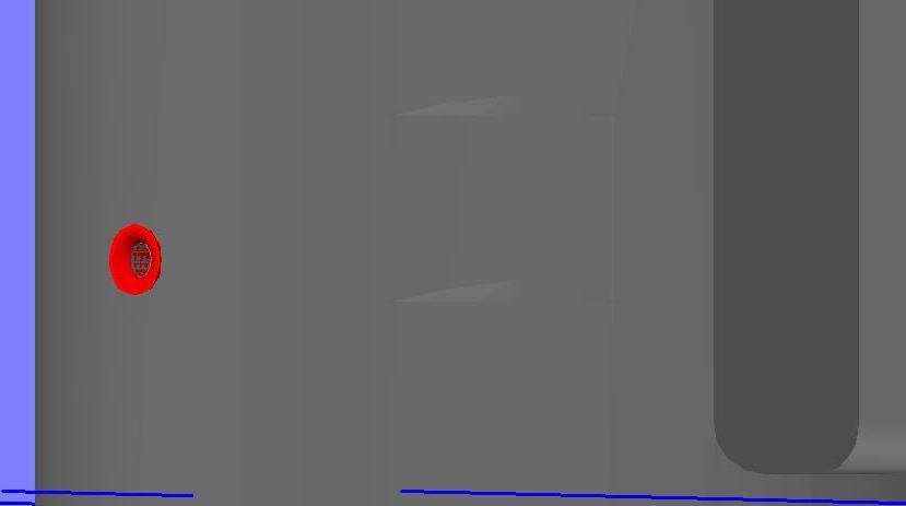

Working around to the starboard side I added yet another unknown (to me) object that appears to be some sort of valve. I based the design on two more Batfish pictures of Tom’s, which are shown below.

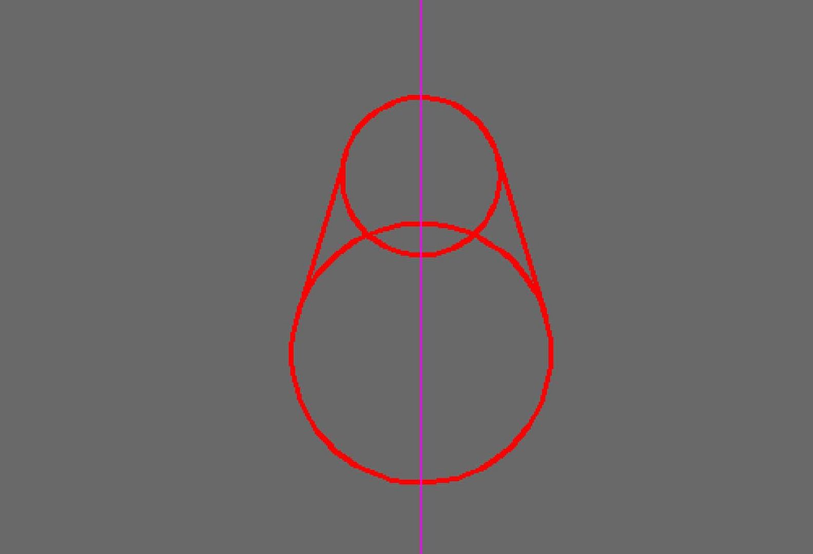

The first steps as always were to position the object and draw the main outline.
In this case the shape was drawn using two circles that were then connected by lines tangent to them.
The unneeded lines were trimmed and the remaining lines joined to form a polyline.
I then lofted the shape through the bulkhead surface. I at first lofted all the way through, but I later filled the back portion using the same shape to create a recessed area, rather than a hole.
At this point I had to use a little modeler’s license and ad lib a bit to make the valves seen in the pictures. The smallest significant (from a modeling perspective) item in the pictures is the valve handle, which appears to be maybe 1” in diameter. Remember, the SLA printer is limited to a diameter of 0.010”, which at 1/144 scale would equate to 1.44” real scale. The image below shows the parts I made to fit into the recess. The blue “handle” and red cylinder are as small as I could make them. I then used a combination of various sizes of hexagons and circles to approximate the items seen in the photos, and I mean approximate.
When joined to the recess and recolored, it looked pretty decent, though not perfect by any means.
After looking at it a bit I decided to make the handles a little bit longer, although they still look a little squatty.
Still, I think they will work, especially when seen in the grand scheme of things.

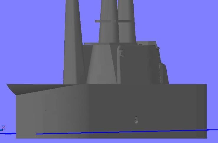

Well, just when I thought I was finished detailing the sides of what I have wrongly been calling the bridge but I think is actually the fairwater conning tower (and what I have been calling the fairwater is actually the bridge), I got a wild hair. In the picture below, which is cropped from one of Tom’s excellent pictures, you can see what I think is a gun access trunk.
Since it is a fairly prominent feature it seemed to me that the model would be lacking if it didn’t include it. I considered making it a separate part, but the model bulkheads are too wide to allow this, so I decided to make it part of the piece that I have been working on, that I will henceforth call the fairwater, unless I find out that I am still screwed up.
Anyway, relying solely on the photo above, and having never seen one, here’s what I did to make it.
It looked to me like the main structure of the trunk was a sphere, so I drew a sphere inside the fairwater and moved it and sized it until I thought it looked right. I then copied the sphere to the side, out of the way, so that I could more easily see what I was doing for the rest of the process.
I first hollowed the sphere using the shell command, to reduce material use then sliced the bottom off at deck level
There appears to be a flange near the top of the sphere where the structure seems to transition to a tubular shape. So, the next thing I did was make a flange with 32 bolts.
I kind of got ahead of myself and didn’t document it, but I tapered the top down to another flange with 24 bolts, then went straight a short distance to another 24 bolt flange, and then went straight high enough to intercept the underside of the deck. I then added the valve seen in the picture.
At this point I deleted the sphere inside the fairwater, and moved the completed assembly inside.
I recolored it at this point, but have not joined it to the piece in case I need to change it.
Adding the trunk to the piece really made for an interesting part, as can be seen in the image below showing a view from underneath.
I made one more modification to the part, and that was to the object aft of the hatch. The more I looked at the one I made, the more I thought it seemed too small. When I scaled it on a photo, relative to the hatch, mine was indeed too small, so I sliced it off, scaled it up in size, reattached it and remade the opening through the bulkhead. I think that it looks better.

Postby Tom Dougherty » Sun Apr 14, 2013 1:49 pm
That object is the antenna lead insulator. If you look at this picture of Bowfin, you can see the antenna wires that stretch forward to the T frame at the bow.
http://www.navsource.org/archives/08/0828726.jpg
The antenna wires were connected through the insulated lead to the radio.

http://www.navsource.org/archives/08/0830522.jpg
OK, conning tower, fairwater, bridge. First, the conning tower is a pressure resistant cylinder that sits on top of the main pressure hull. It is a smaller version of the main pressure hull. It is the location from which submerged attacks were conducted in WWII. It contains the two periscopes, the Torpedo Data Computer, some sonar, additional electronics, and a steering station. In diagrams, it is the smaller cylinder, which is normally NOT VISIBLE, because it is surrounded by the streamlined structure known as: the Fairwater!
Here is a "naked" conning tower with no fairwater surround:
It is located and accessed from a (watertight) hatch in the control room, and has another (watertight) hatch that leads up to the bridge.
The bridge is the location from which the submarine is conned when on the surface. It is at the forward part of the fairwater. Orders are relayed below through a bridge speaker (large black object), and the hatch down to the conning tower is also visible. Also prominent is the Target Bearing Transmitter (TBT) with its optical system, a pitometer, and other pieces of equipment (black objects) are also at the bridge station.
Modern US submarines do not have a conning tower, and have much more streamlined "sails" which house the various masts. Without the need to house a pressure resistant structure, the sails are much narrower and compact. All ship steering, ballast, navigation & attack functions are now centralized in the control room inside the pressure hull.
When the fleet subs were converted to Guppy configuration post WWII, the fairwaters were streamlined to reduce underwater drag. The conning towers were still underneath the new fairwaters (which were called sails), and still employed as the attack center. Most US nuclear submarines were built without conning towers under their sails. (Sub Quiz Question: the two early nuclear sub exceptions to this were?)

Postby salmon » Sun Apr 14, 2013 7:02 pm
Looking into the access door
We can also see the conning tower proper.
