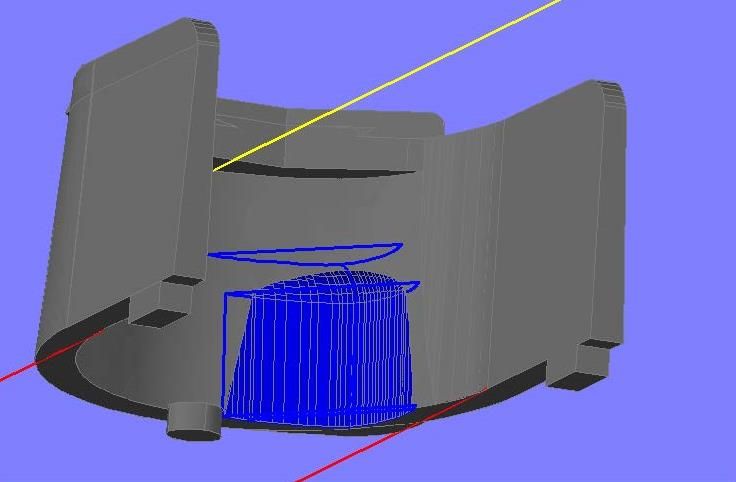

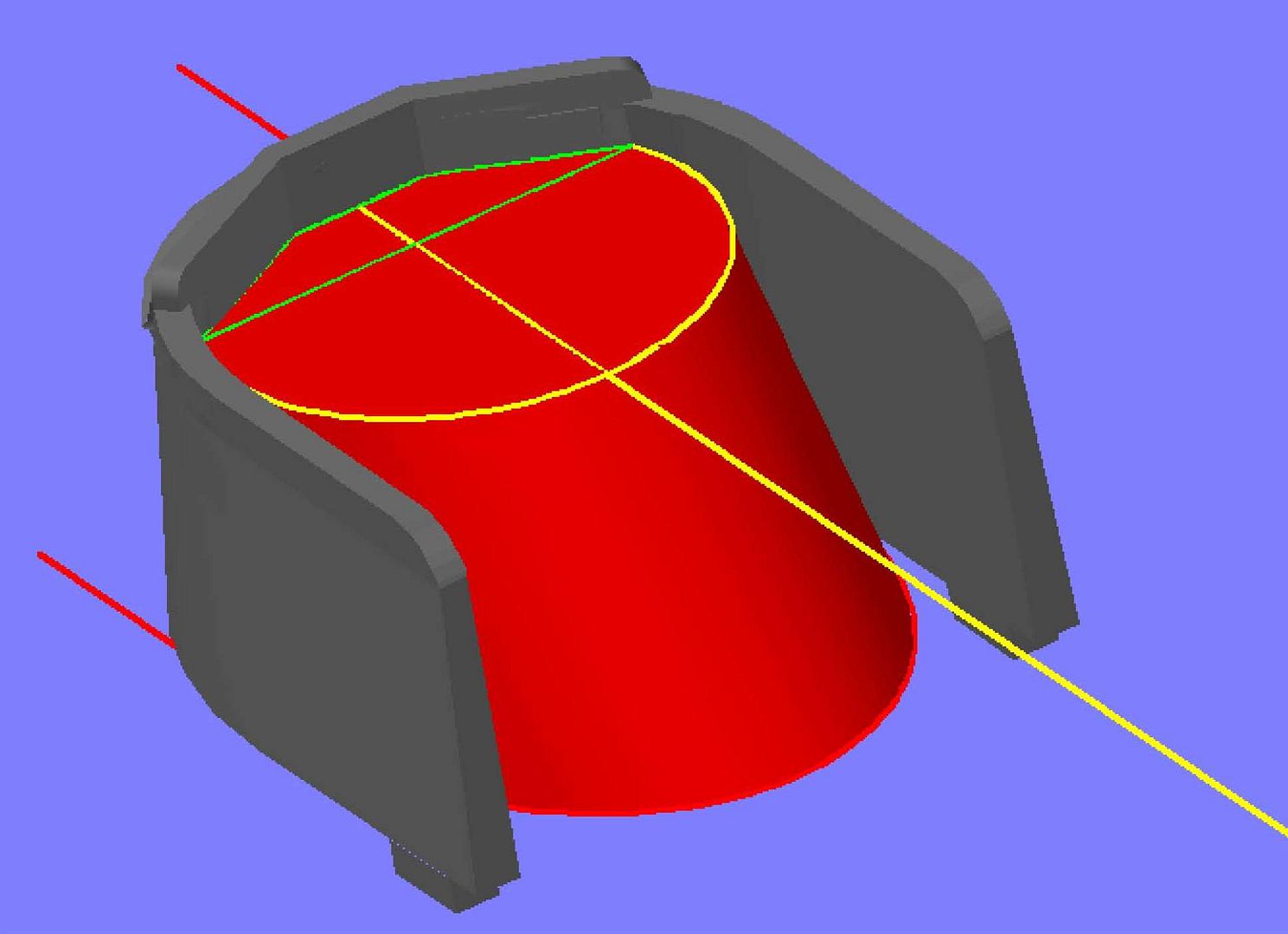

I started by drawing a circle and an ellipse, in preparation for thinning the forward face of the fairwater.
Which I then lofted…
…And subtracted.

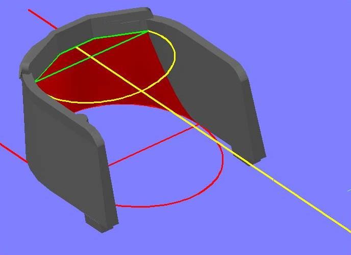

I then prepared to cut out the bulge on the inside. The polylines shown in the image below were created by tracing the outside surface of the bulge and moving it in to maintain the proper thickness.
The polylines were then lofted, with an elliptical arc being used as a path between the top two sections, and the resulting shape was subtracted.

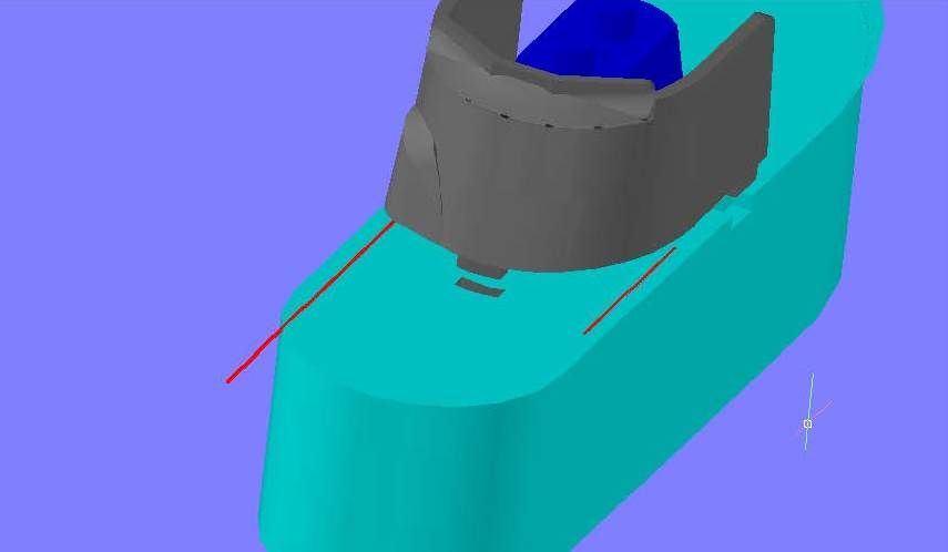

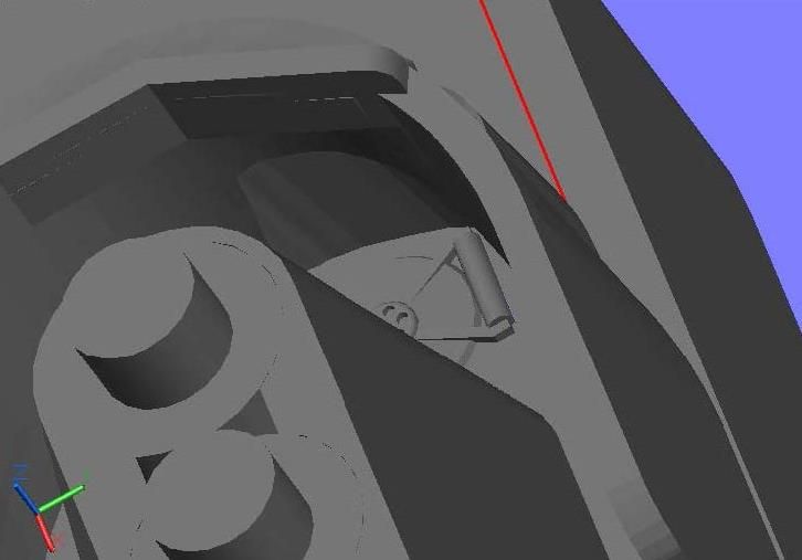

Doing this left the forward knob, for attaching the part to the bridge, hanging mostly in space, as can be seen in the previous image. So, I sliced it off and added a new attachment stud to the front edge.
Having modified the connecting points on the fairwater, I had to modify the bridge accordingly, so I opened the bridge drawing and copied it to the fairwater drawing. Since I used the datum points to copy it, it was positioned correctly and so I subtracted the fairwater from the bridge to create the female mate to the stud I just created. I then copied it again. In the image below I moved it for snapping the image. Note that I also opened the conning tower drawing and copied it to the fairwater drawing in preparation for my next endeavor…

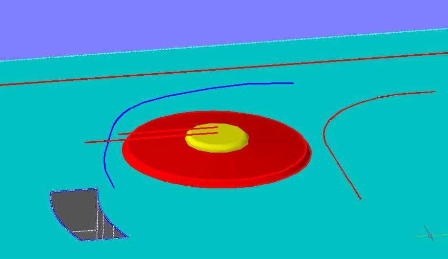

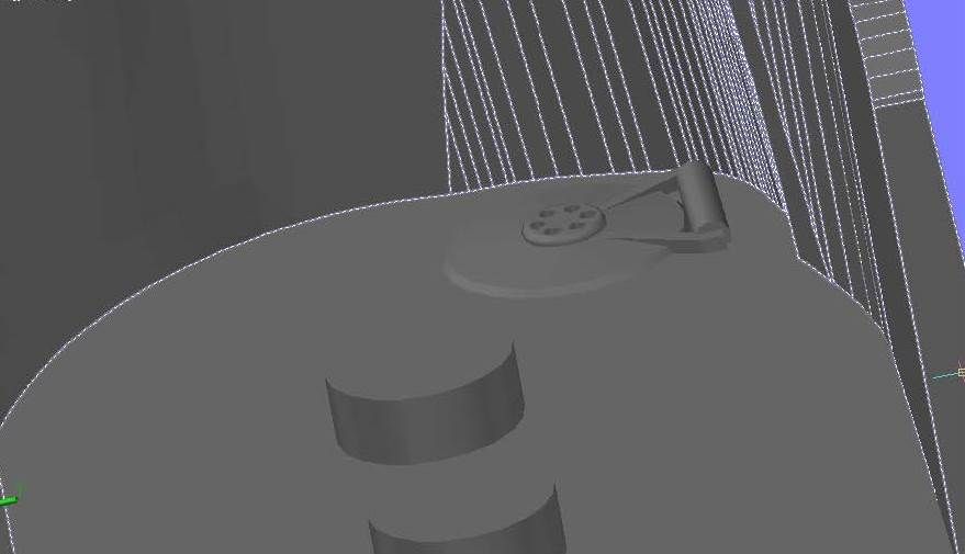

…Which was the forward bridge hatch, which was made possible thanks to the excellent picture TomD posted. In the image below you can see the tracings of the outside edge of the conning tower (red) and the inside edge of the fairwater (blue). The red solid is the first level of the hatch. Due to the fact that my bulkheads are considerably thicker than the real deal, the scale is not correct. I don’t know the true dimensions of the hatches, but I would guess them to be at least 2-1/2’ in diameter, and probably more like 3’. The diameter of mine is only 2’ in diameter (1/4” at 1/144 scale). Note the attachment hole I created previously (gray).

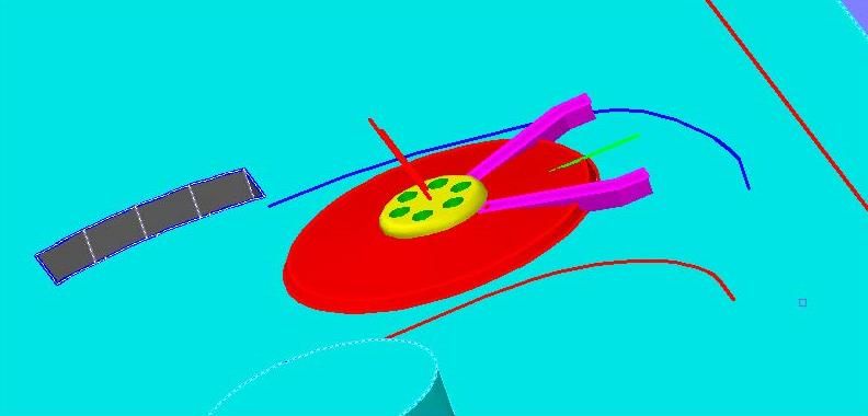

The yellow in the image below is the start of the handle. Although you can’t really see it, the surface slopes up from the outside edge, to the handle.
Next, I drilled holes in the handle. I used circles, because even though the holes don’t appear to be circular on the picture Tom D posted, at this scale, circles will work, I think, if they are even visible.
The support arms for the hatch were made next using an extruded polyline that was then mirrored around the center axis of the hatch.
Finally, the hinge was created using a circle lofted between the arms.
The various components were then joined to each other and attached to the bridge.
Having completed the hatch, I isolated the bridge and copied it back to the bridge drawing, after deleting the previous version.

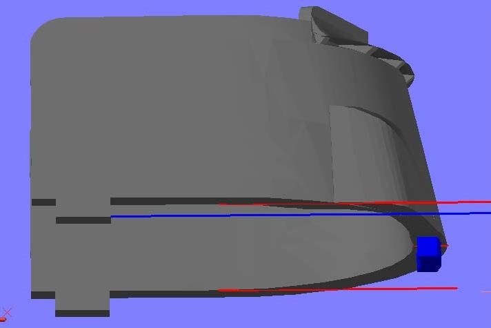

Postby rdutnell » Sun Mar 31, 2013 10:43 pm
UPDATE 20
Greetings once again everybody!

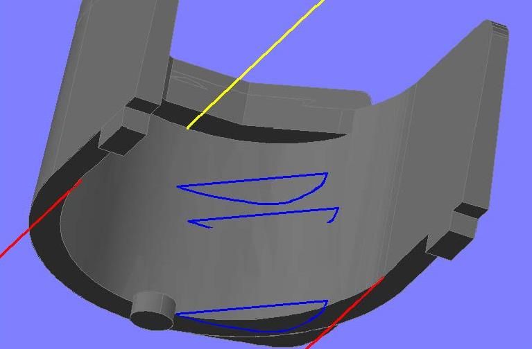

I have one more post for the weekend as I just finished adding the navigation lights to the fairwater. I had two great pictures provided by Tom that really helped this process.
Due to the small size of it, I didn’t get too carried away trying to match it exactly, but I think what I did will work nicely.
As usual, I started by drawing the shapes I need using polylines or converting other items to polylines. In this case I joined to identical circles with lines to form the cutout, and a rectangle and ellipse to create the cover, or outer portion.
I then filleted the inner edge of the cutout shape (green) at 0.15’ to provide the rounded cutout as seen in the photos.
Next, I moved the cutout shape into position, and mirrored it before subtracting it from the fairwater. Note the nicely rounded shape of the cutout.
After this I drew another rectangle for the cutout where the light would go.
The next image shows it from the top and you can see not only the lofted cutout (yellow), but also the curved shape of the outer portion of the light.
The image below shows the cutout of the light before final positioning.
At this stage, I moved the shape into the hull and because there is a slight slope to the fairwater bulkhead, I had to rotate it a little too.
I completed it by mirroring it to the other side and joining them to the fairwater.

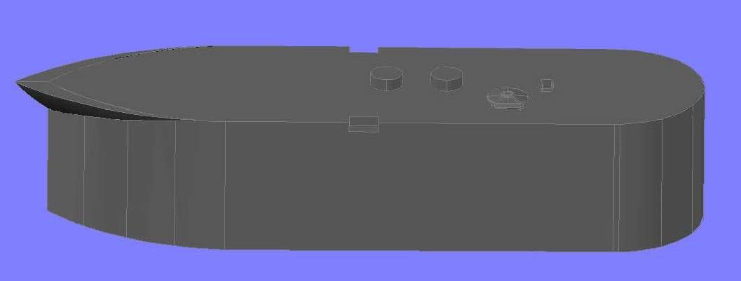

Postby rdutnell » Tue Apr 02, 2013 9:58 am
UPDATE 21
Good Morning All!
I had a go at the anchor, which was an interesting and somewhat challenging experience, especially since I have never physically seen a fleet boat anchor. Fortunately, the pix on Tom’s Photobucket site include one really good picture of the anchor, which my design is entirely based on.
Using the photo, I first prepared to draw the cross section using arcs, a circle and lines.
I did half of it, mirrored it, and then joined the parts to form a single polyline. I thought my first attempt was rather thin, so I modified it slightly to make it a bit thicker at the lower end.
I then did half of the front view and mirrored and joined it in a similar manner.
Next, I aligned the axes, rotated the section 90 degrees and lofted both of them.
I then used the union command to get the basic shape, and cut a notch in the middle.
At this point I made the attachment arm.
More work still needed to be done at the bottom, so I sliced it in half and deleted half of it.
At this point I did several things. I had first tried filleting the edges before I sliced it, but it wouldn’t work. I tried again after slicing and was able to get the inside edge to work, but never did get the outside edge to. Then, since the lower part tapers from rectangular to circular I traced the sliced end, and created a rounded end…
…Added guidelines…
…And lofted it.
Somewhere in the process I decided that it was too wide so I shortened it.
Drilling the holes was next. I used extruded filleted rectangles to do this. After extruding and subtracting the shapes, I filleted the edges to round them
At this point, I started on the bottom by lofting two circles.
The “wedge” was somewhat more complicated, and consisted of two similarly shaped polygons with the outside being smaller. After lofting them, I filleted the edges to round them.
I should perhaps say at this point that I have no idea what the backside looks like. Perhaps it is the same I don’t know. I considered mirroring the “wedge” to the backside but chose not to. I save all my construction lines on a separate layer so if need be I can always add it later, but it is going to be against the hull and won’t be visible anyway, so I don’t think it really matters.
Anyway, the next step was modifying the hull to accommodate the anchor, but that is for the next post.

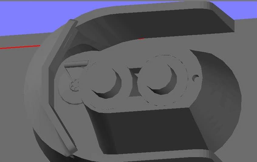

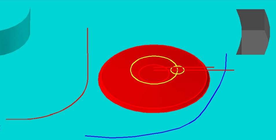

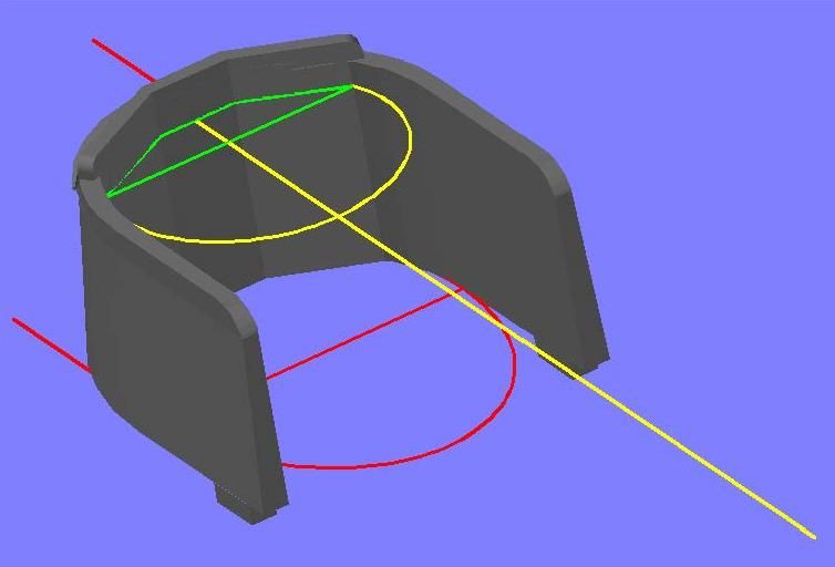

Postby rdutnell » Tue Apr 02, 2013 10:33 pm
UPDATE 22

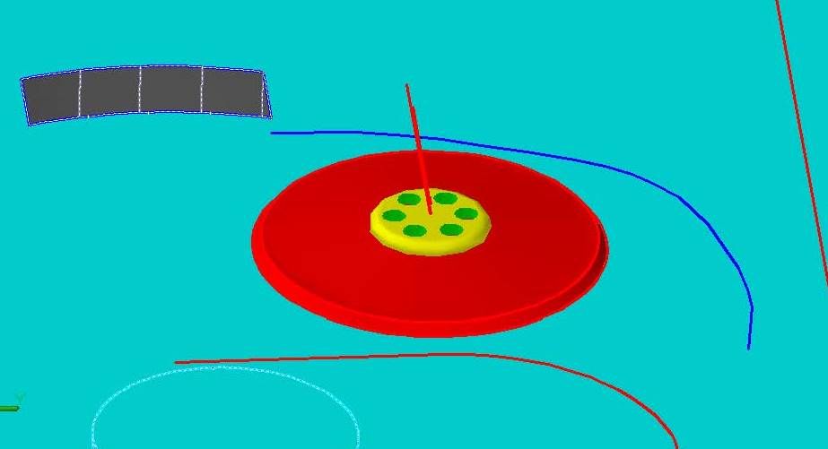

As I said at the end of my last post, the next step was to modify the hull to accommodate the anchor, so I had a go at the well. I began by tracing the faint outline of the well on the “Outboard Profile” drawing.
The well, as with all of the parts of this model are tied t o a common reference datum. Although I didn’t mention it in the previous post, this also includes the anchor. In the images below, you can see the well in the lower part of the drawing. You can also see various construction lines and the completed anchor as shown in my last post, as well as the photo I based the design on.
To begin the process of making the well, I rotated the anchor, moved it to position, and scaled it to fit the traced well lines. I then copied and pasted it into the “hull1” drawing. You may recall from a previous post that I segmented the model because my file was getting too big and it was really slowing my computer down. This hull1 piece will be sliced into two, and possibly three, pieces when I make the “kit”.
I should perhaps point out that the datum is located along the centerline of the ship, so when I copied the anchor and tracings to the model, it was in the center of the ship and had to be moved outward to the correct location (left and right, or port and starboard). Also, you may have noticed in the last image that the well outlines are slightly different than the drawing. This was done to more accurately match the picture and the two polylines shown were created through a trial and error process to get the well right (more or less).
As with many features in this adventure, I do it once and then mirror it to the other side. In this case, I had mostly completed the starboard side when I realized that I hadn’t been documenting the process, so here’s what I did on the port side, which is similar to the starboard side, without the trial and error bit.
Note in the image below that when I mirrored the anchor, part of it was protruding into the hull, as it should be, hence the need for the well.
In the image below, I turned off the model layer, so you can better see what I did. The trial and error bit was done to get the locations of the inboard green line and magenta lines in the proper locations to produce the desired shape of the well. This required lofting, subtracting and looking at it, deleting the solid, moving the line a bit and repeating until I was satisfied. I couldn’t tell you how many times I did this, but it was numerous. When I was happy with it, I lofted the green lines first…
…And subtracted them from the hull.

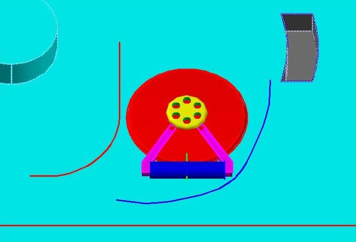

You perhaps have noticed that the attachment arms (I’m sure it has an official name) have been a different color than the anchor. This is because I haven’t joined them yet. Knowing that I needed to subtract the arms from the hull, to make the attachment point, I copied the arms, along with the tracings for reference, up out of the way. Note that for some reason I rounded the corners of the arms, which wasn’t necessary as they will eventually be joined to the anchor and won’t even be visible. Oh well.
In the image below you can see the result of subtracting the port side arm.
At this point I copied the arm back down and joined it to the anchor.
This is where things got interesting. When I started on the hole for the anchor arm, I realized that the center section sloped the opposite direction from the hull back to the bottom of the well. This was not an easy piece to make, but after numerous tries and a bit if frustration, I got it close. The hole is perhaps a little lower than in the photos, but with the rounded edges I put on the outer edges of the shape and the hole, I think it looks fairly decent. Again, it’s not perfect, but overall, I’m happy with it.
After completing the port side, I mirrored these last changes over to the starboard side, and completed the process.
