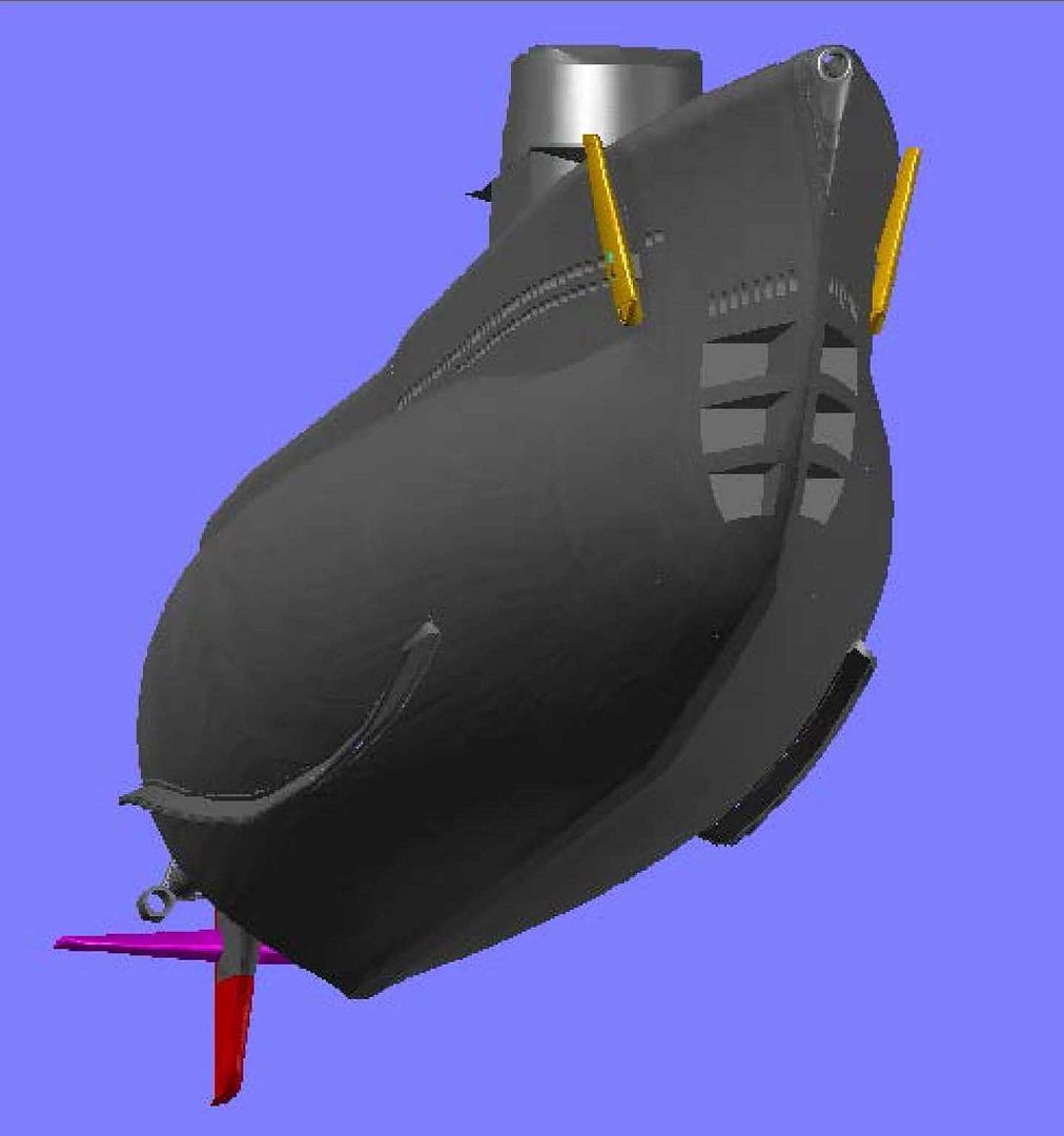

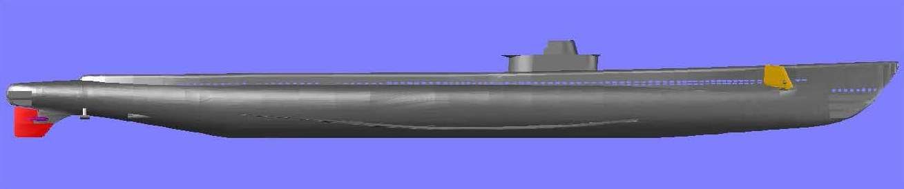

With the assembly completed, the next step was to copy and paste it into the Batfish drawing. I knew, more or less, what the horizontal positioning was, so I started by positioning the assembly at that point, but, in the end, the final positioning was done by eyeball. As you can see, this resulted in good alignment, and the two objects blend nicely into one another.
The final step was to attach the sternpost to the hull, and recolor it. In the process, I experimented with colors and decided to switch to a more “silvery” color. I left the rudder red at this point because it will be a separate piece. In fact, with the SLA, I could build it in place, and still have it be moveable, although it may be too small for this option.
Now, it’s on to the stern planes.

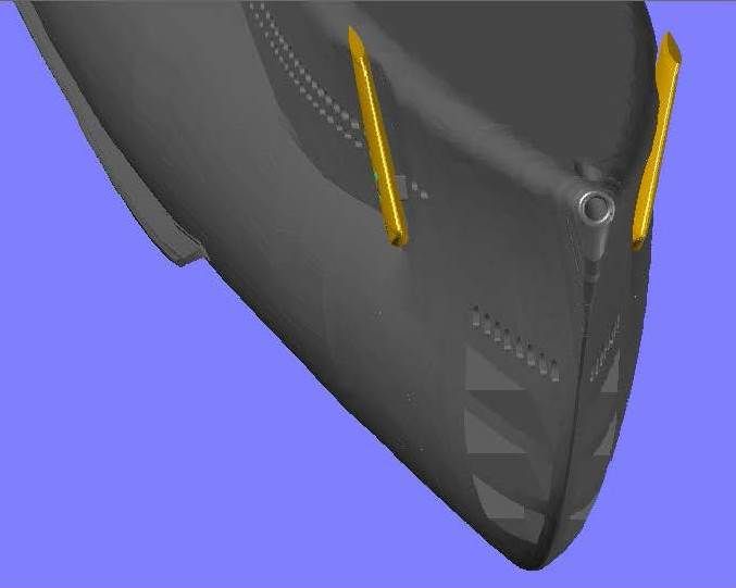

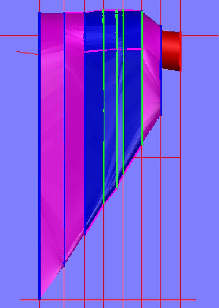

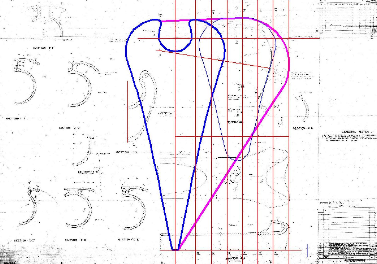

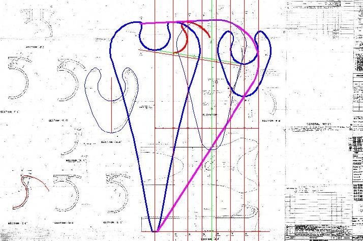

Well, I decided to try to redo the bow. This required using two new additional plan sheets, the “Bow Framing Sections A to 9 Incl.” sheet and the “Stem Casting & Fairlead” sheet. The latter was discussed earlier, and even though the quality isn’t very good, I finally deciphered it. I must say that this was the second most difficult part I have made to date, the hardest still being the Greenling screw. I didn’t get it right the first time, that’s for sure.

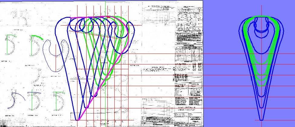

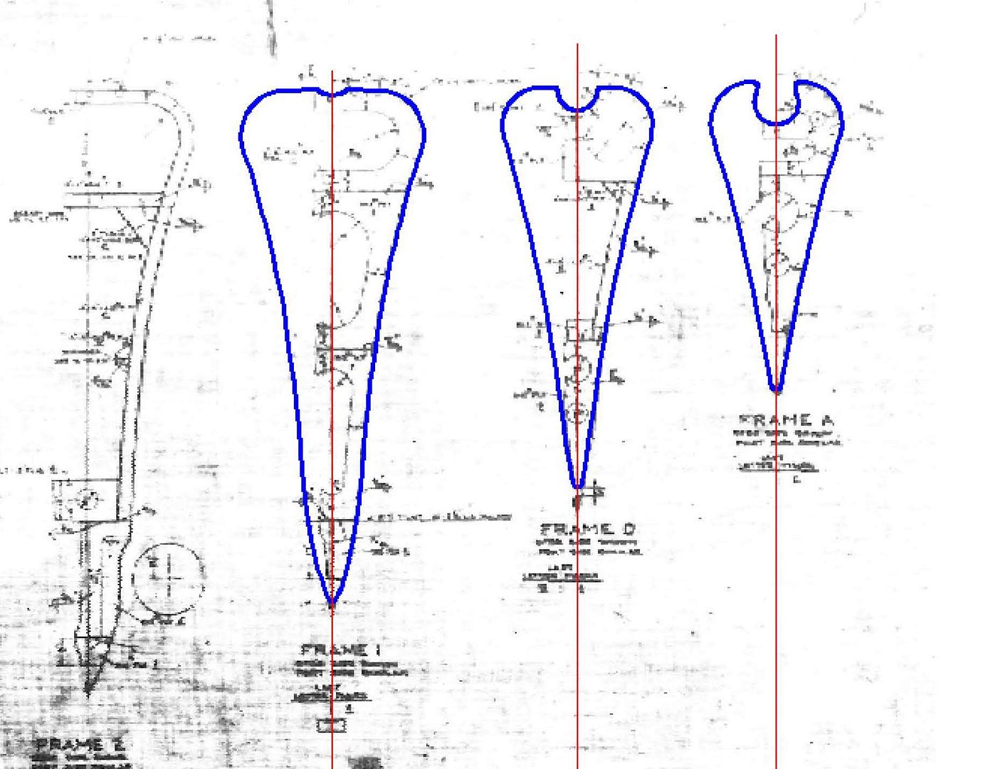

To start I traced Frames 1, 0 and A from the “Bow Framing Sections A to 9 Incl.” sheet, after first bringing it into AutoCad and scaling it of course.
I then copied them to the proper locations on the hull datum, rotated them and lofted them. This was the easy part.

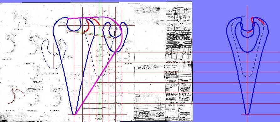

From here I switched to the “Stem Casting & Fairlead” sheet. Shown below are Frames A and B positioned correctly on the drawing.
I started with Section G-G’, as may be seen below.
I next started on Section C-C’, but as you can see the remaining sections only show the top part.

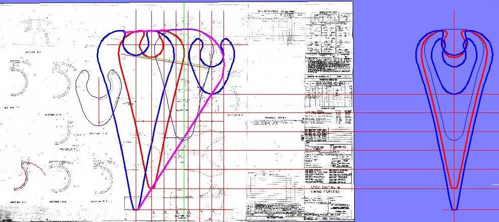

At this point I copied and rotated the four sections to the side of the plan sheet.

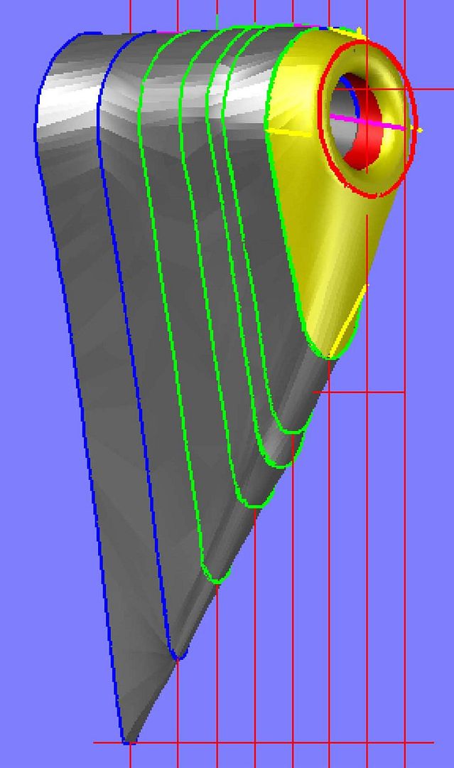

Section C-C’ was completed by estimating it’s position between existing sections and drawing a polyline. When half was completed, it was mirrored and joined to form the section.
The remaining sections were created in a similar manner. In the image below, the blue sections are open. And the green sections are closed, with a hole drilled through them.

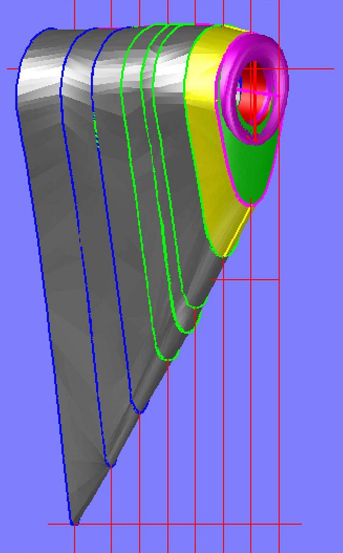

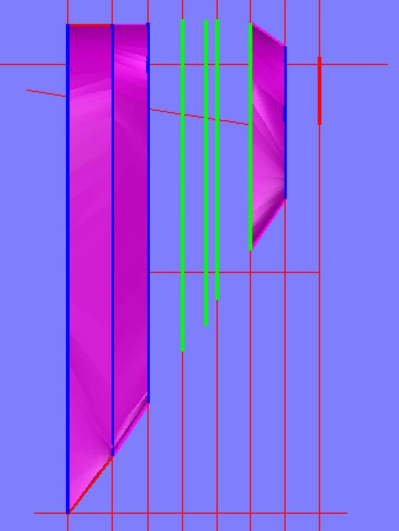

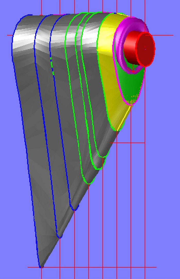

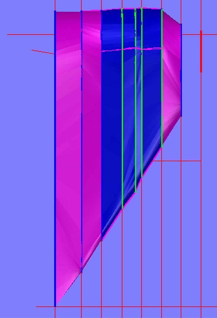

The closed and open sections won’t loft properly. It’s like comparing apples to oranges, so I reasoned (partially correctly, that the end closed sections needed to be duplicated, but with small openings, to accommodate the transition.
I did the open sections first…
…Followed by the closed ones. The magenta lines are “Guides” for better lofting.

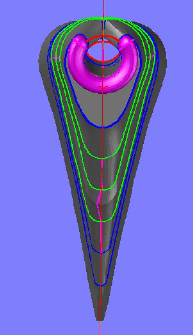

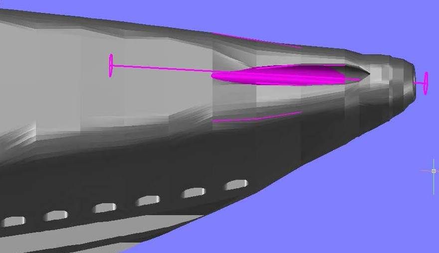

I then extruded a circle along the axis provided on the plans…
...And subtracted it. The results were mixed. The aft end was good the forward end was not. I don’t know what I was thinking.

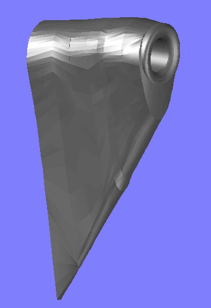

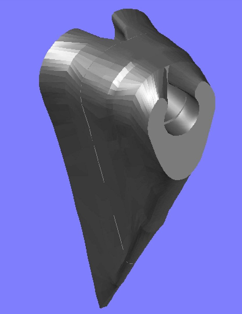

The good news/bad news is that since my brain was on holiday, it took me a while to realize the idiocy of what I had done, so I traced the ends of the outer section (Section G-G’), revolved them 360 degrees, then rotated them between the ends, thinking that I would round off the end in this manner.

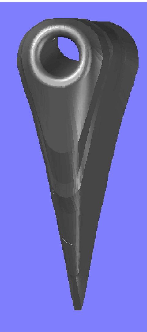

It was at this point that I discovered the folly of my ways, and redid it. This required modifying Section G-G’ to make it closed and lofting to it from Section F-F’. I also closed the loop.

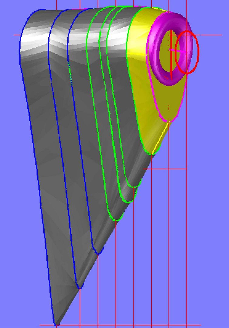

Next I extruded the circle again, and created a tapered surface by lofting between Section G-G’ and a circle internal to the loop.
I then extruded the circle and filleted the edge of the circle.
This was better, but still not quite right.

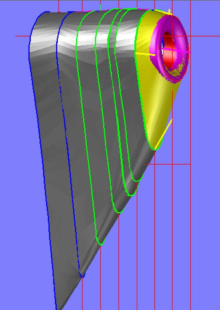

So, I tried yet again.

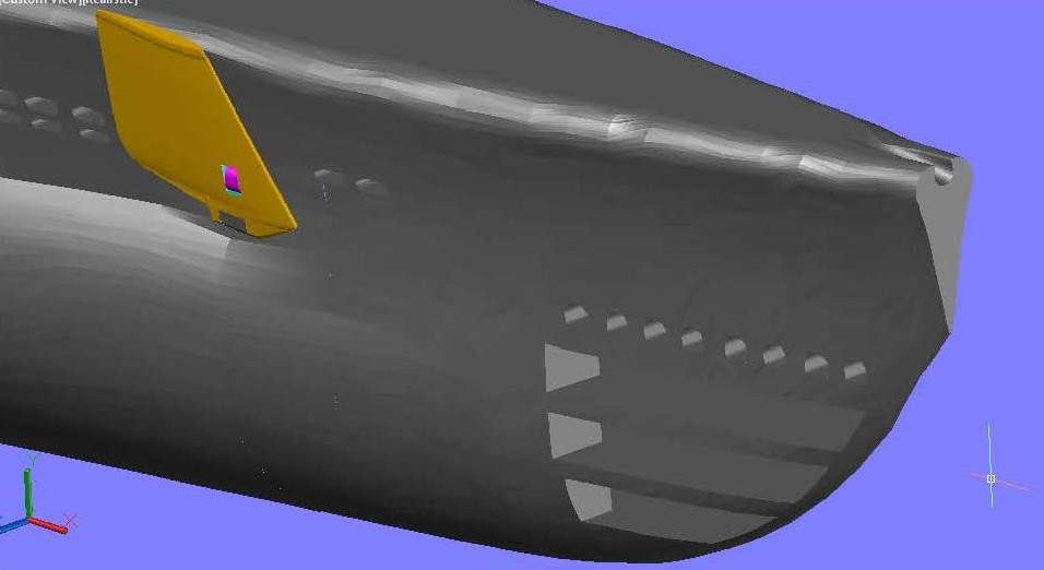

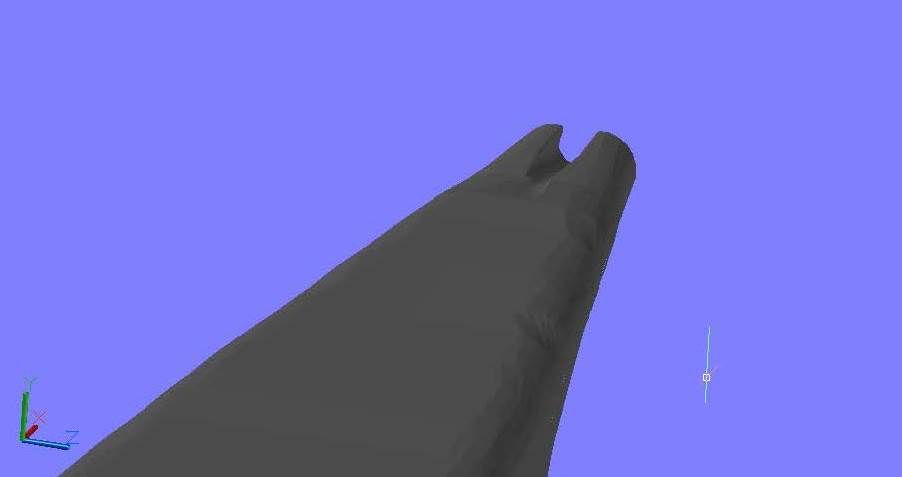

This was looking better, but in the process of filleting the circle surface it occurred to me that maybe I could fillet the other edge of the yellow slice and do away with the loop all together. After some trial and error I discovered that a fillet radius of 0.18, gave the desired result.
It looks a little rough at this scale, but it looks better on the ship.

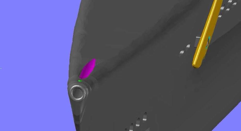

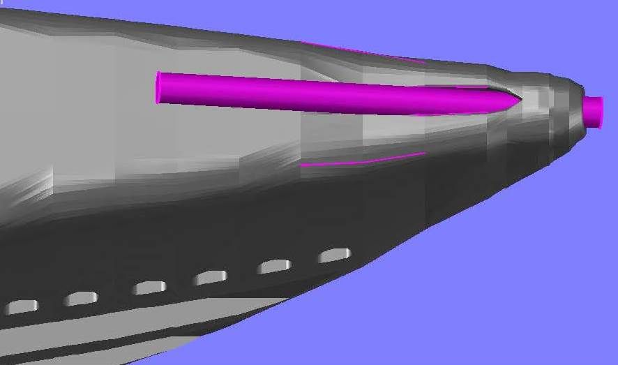

Out of curiosity, I extruded the circle once again along the axis provided in the plans.
It’s a good thing I did, because you can see that there was a little extra cut.

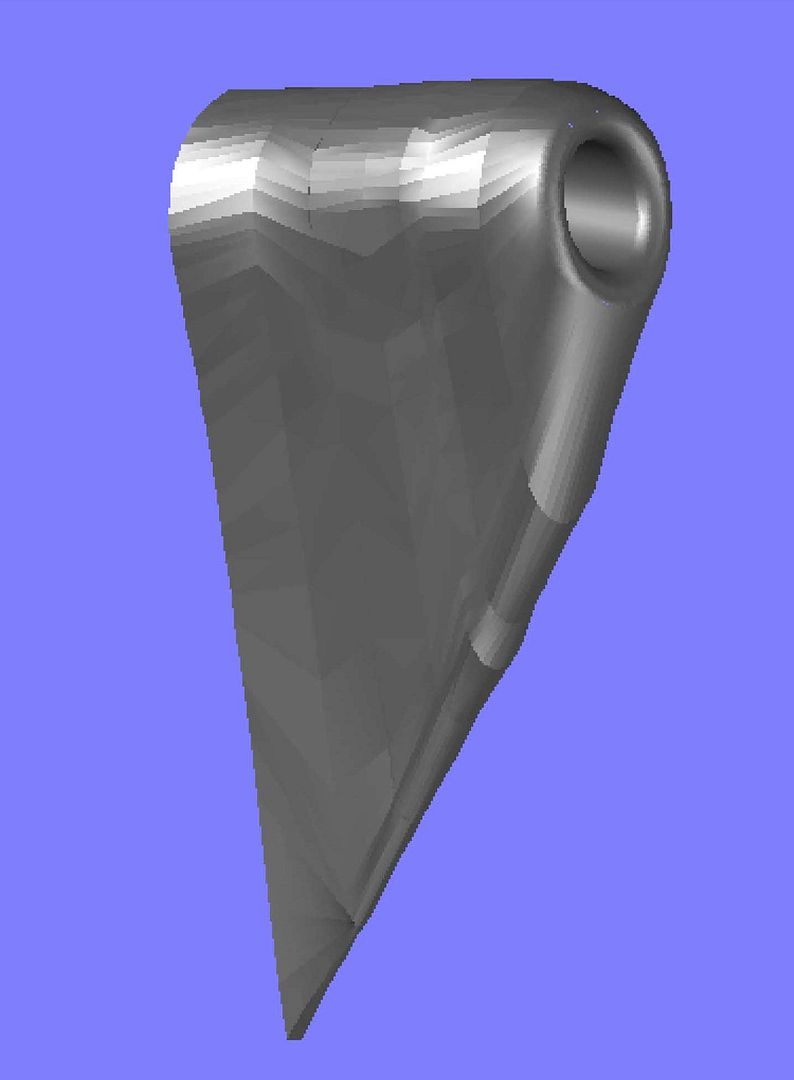

The last thing I did was drill the hole topside and join it to the rest of the ship.
It’s not perfect by any means, as a result of me having to guesstimate the lower parts of the sections. I could probably improve it by trial and error, but that would be a very time consuming exercise, and if need be, a little sanding will correct it.
Anyway, it was a lot of fun, even if it did take me about 12 hours to do. Now for the screw! That’s what she said!
CHEERS!!!
