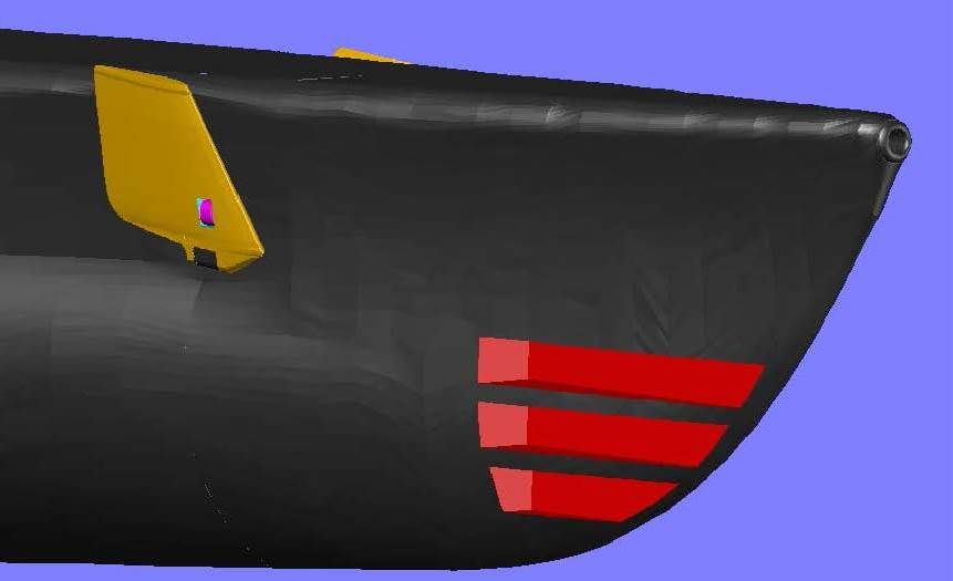

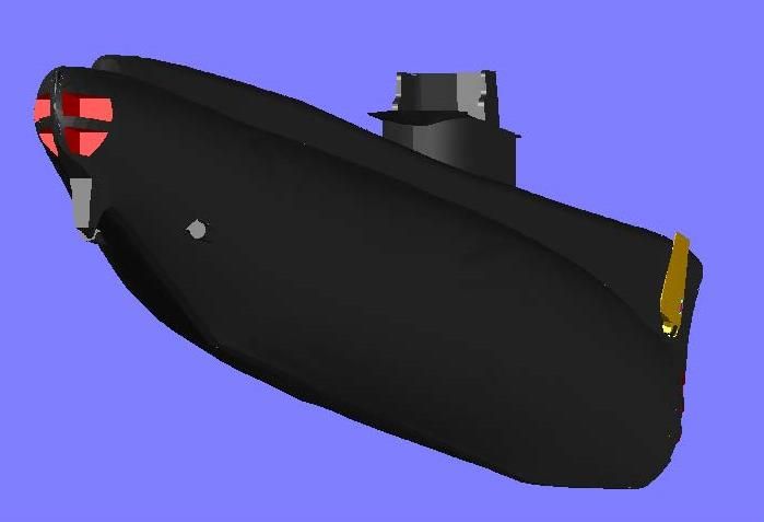

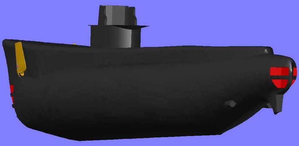

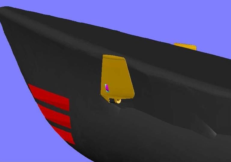

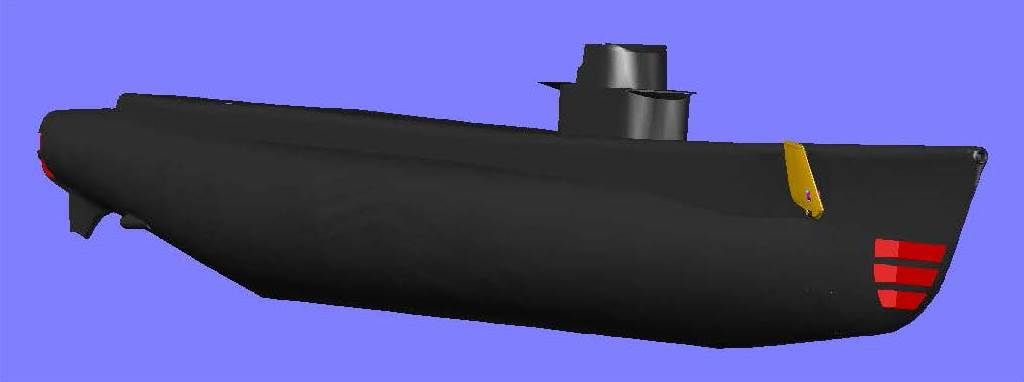

The next items to be completed were the bow planes, which were created using the “Bow Diving Gear Plane Details” sheet and pictures of Batfish. The pictures were required because the configuration in the pictures I have of Batfish is slightly different than the configuration on the plans.
Below are some images of the ship up to this point. The bow plane is a separate piece and thus is colored orange. Also, I am uncertain about the upper hull attachment point, so at present it is still detached and colored magenta.

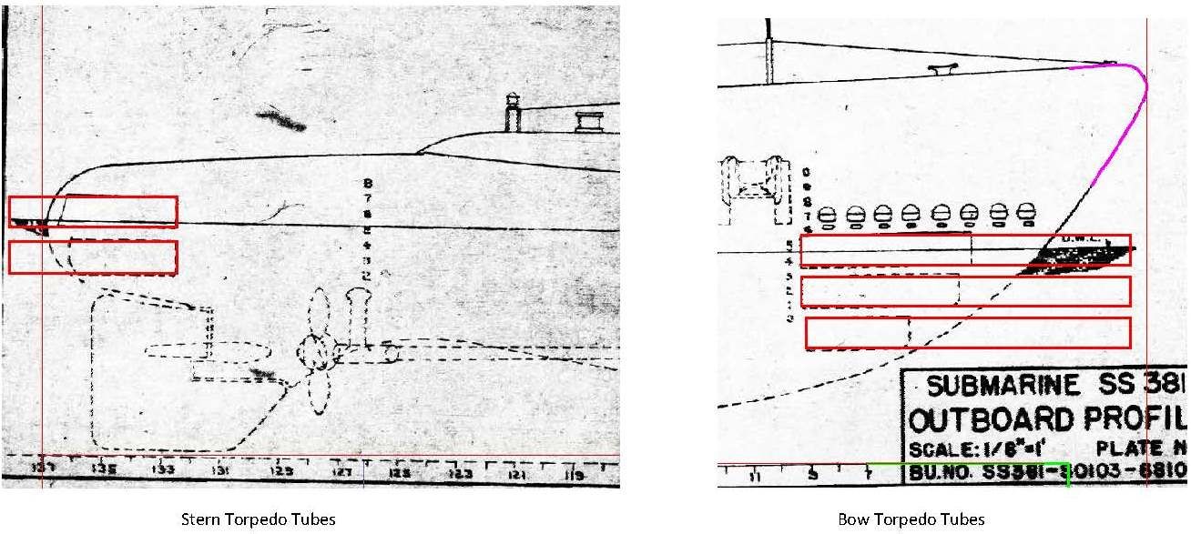

The next thing I did was cut out the torpedo tubes. I did this by first tracing the outlines from the plans, extending them well past the outline of the ship.
These rectangles were copied to the correct locations on the 3D hull, lofted and then subtracted. The remaining images on this post show the Batfish model as she currently stands.
