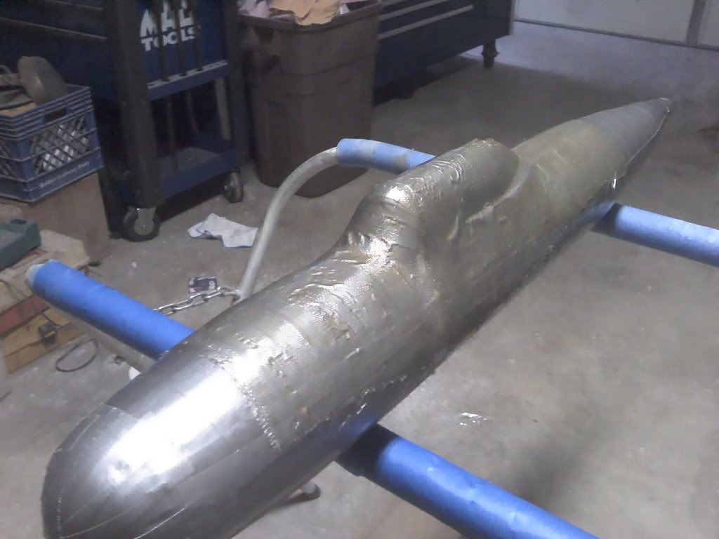

lol. should have mentioned that... i used a bandsaw that i have here to cut the sections out after drawing them on the foam. once they are all cut, i align my pieces and glue them together with hot glue. it seems to work so far, and doesnt melt the foam to badly while making a decent bond that if i mess up, i can take back apart (with some effort). then i take my handy dandy wood rasp and rough shape my sections, final shaping is done with 60 grit sand paper. lastly, if i need additional contouring, i found drywall compound works well. it shapes easily and crumbles when you hit it hard. time will tell how well it actualy works. i wrapped my alfa in duct tape and have the first fiberglass coat curing now. :D

Well, a year later and I finally pulled the IXD2 out. I had to break it into 3 pieces to move the submarine. I recently moved to the Kansas City MO area after getting married this past June. I put the plug back together this morning, and started on the drywall compound sculpting again. After learning some new things about the IXD2 and it's hull, I am starting to incorporate these new things into my master plug. As I found out from the Alfa, I will be molding this one to make life easier. The new plans are to use the Jeff Jones method and paint the plug with latex based paint, rather than the duct-tape method I used on the Alfa. I was not happy with the duct tape, and lost details on the Alfa that I had to re-sculpt. I plan on getting the IXD2 plug finished before October, and would like to have the first hull pulled out of the molds before Thanksgiving. Time will tell!
