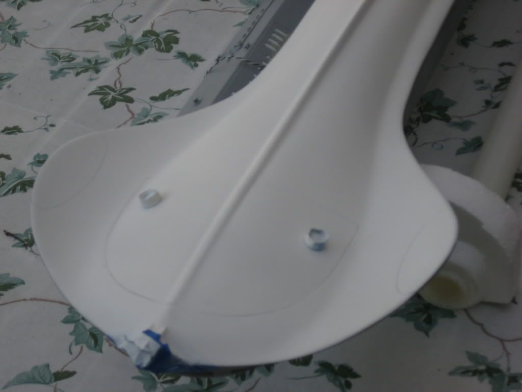

These three shots show repair work completed on the three big hull splits. Again, this took a lot of time, but seems to have turned out okay. Repainting will tell, another week or two—or more—down the road.
Initially loved Steve Neill's nifty twin (actually quadruple) magnet system to snugly hold down the superstructure to the hull. But as it turned out, the aft magnet setup was recessed too far into the hull for easy clearance by the WTC when installing or removing it. In fact, the lower magnet was accidentally torn completely out during one of those evolutions in Carmel. Hated to do it, but the aft magnet design simply had to go. Here you see where I've removed the mating magnet in the aft end of the superstructure, and am about to fill the hole left in the upper hull by the loss of the other. For expediency, I just used CA and baking powder; this hole will be covered by the far aft point of the main deck anyway.
Here's my replacement solution: a metal tongue and groove. Couldn't believe how long (and how many attempts) it took to fabricate the proper groove or "slot" piece you see here. I'd long considered this setup for one end or the other of the superstructure, but was quite happy to let Steve take things in his own direction. Now we're obviously back to my original plan, though I fully admit to being inspired to this approach by Kerry Addington's similar solution within his big Seaview.
Here's the groove piece JB-Welded in place.

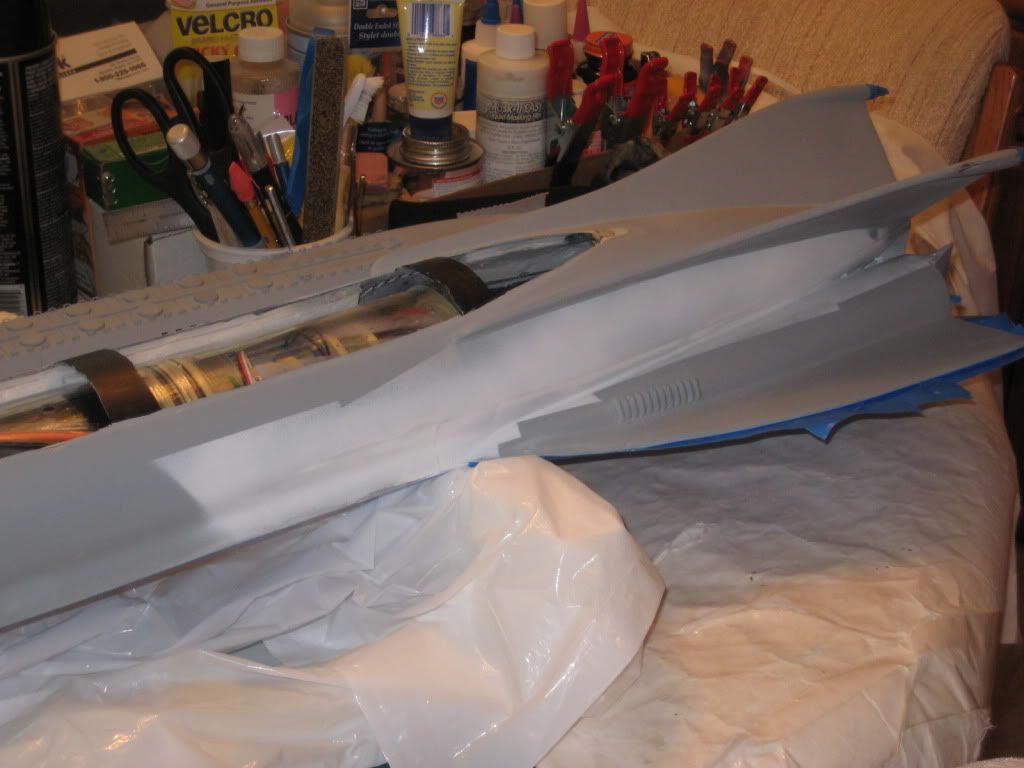

Once again this thread is long overdue for updating. Sorry about that, guys. Those following along from above may be interested to know that I did indeed get Seaview ready in time to take with me to the West Coast Fall Fun Run in San Francisco back on that first weekend of October. She wasn't fully finished, and therefore not at her best, but she was in good enough shape to run and did put forth an encouraging performance. She still has significant trim and sail plane linkage issues—plus assorted other miscellany requiring attention—but I did successfully get her to run, turn, dive, surface and come back, all while looking great and turning heads. Look for my photo-heavy coverage of the whole SanFran Fun Run event in the forthcoming December issue of the SCR. That same issue will also feature the first in a series of build articles detailing my specific approach to this boat for any interested in seeing how it got started. Now I'm eager to get back to work on her of course, but the holiday season and some very involving upcoming home remodeling work will no doubt keep me away from her till sometime early in the New Year. Till then, I figure I can at least present below the additional refit work which permitted her to patrol those Golden Gate Park waters. So here we go....

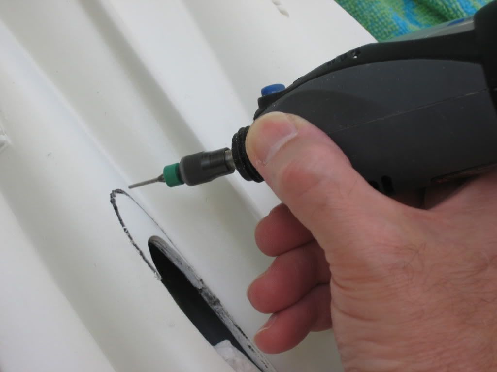

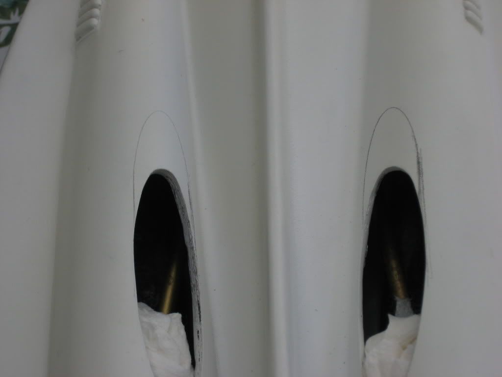

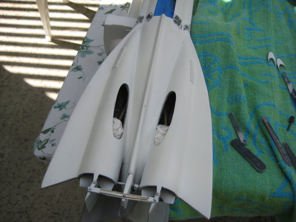

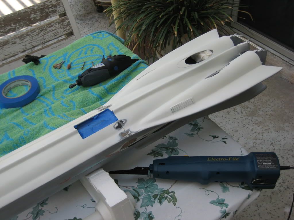

We start here by marking the pumpjet water intake openings for enlargement. I found out in Carmel that the boat was significantly underpowered; more water for the pumpjets should equal better propulsion.
Setting her up to enlarge the holes. Note also I once again attacked the joint between the hull and the aft engine assembly. That gap was bothering me, requiring more filler work.
Cutting out the holes, first with a reciprocating saw, then shaping the final cut with a small grinder on a Dremel.
Here they are, successfully enlarged. A little sanding to further smooth the edges, then on to the next task.
Her white keel now gets repainted.

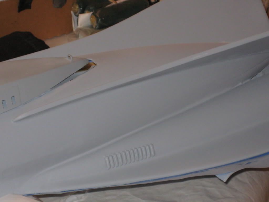

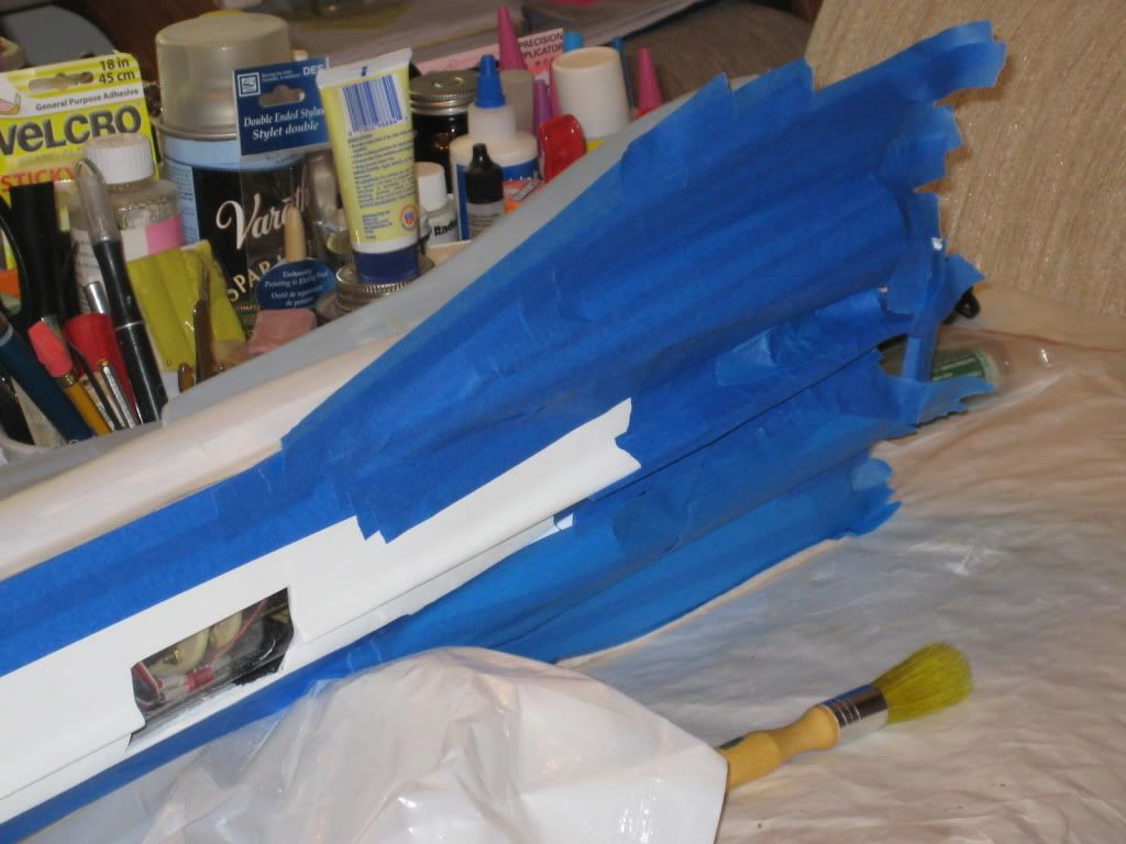

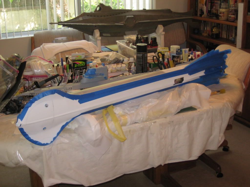

Now to mask in prep for priming the areas where all the hull split repair and joint reworking had been done.
Primer's now applied to the specific target areas.

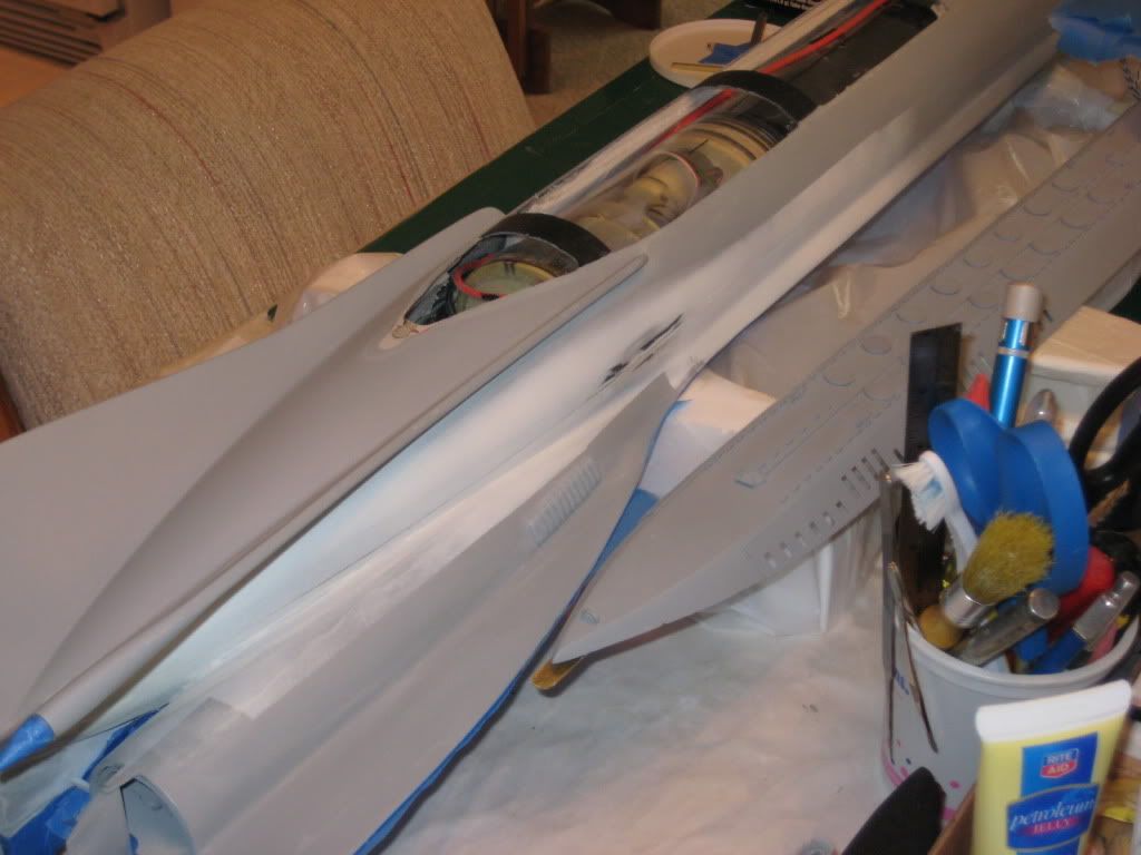

Some filler resanding done here.
Repainting the primered portions of the hull with what was left of the custom-mixed Seaview medium grey color I'd acquired from Steve Neill once he'd finished the build.
But of course I ran out, so had to mix up a batch of my own using Steve's very specific recipe of Model Master acrylic paints. The "R" here is for the Real paint. The "T" is for my Test color. After much experimentation and mixing, I'd really gotten it darned close. The "plus" sign truly tells it: the vertical line is in the original color. The cross hatch is my recreated color. A major success, and not an easy one, believe me. But I'd have been sunk if I couldn't match Steve's special color; I really didn't want t have to repaint the entire boat from scratch!

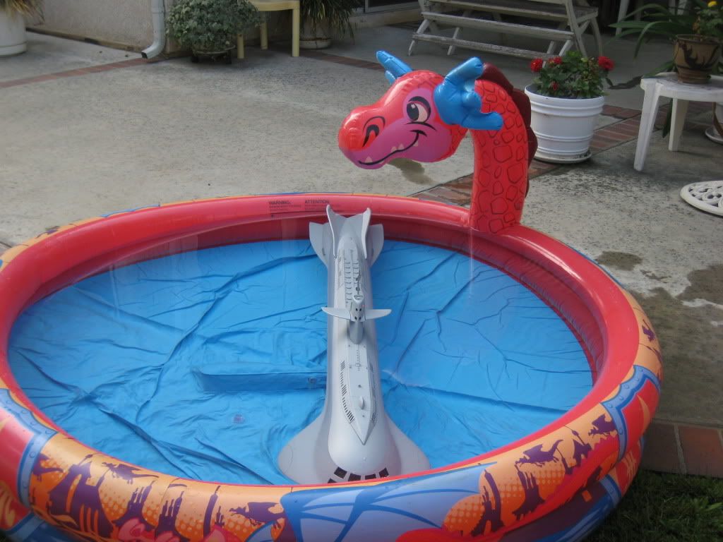

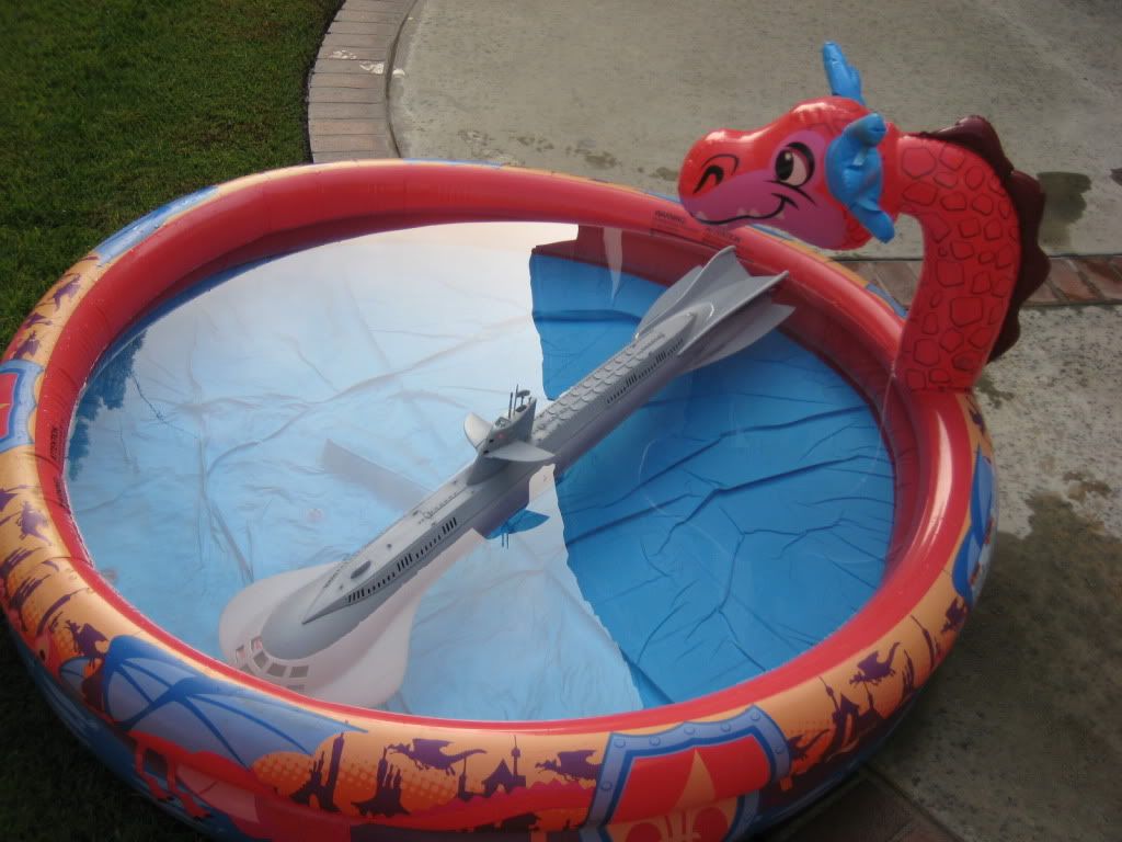

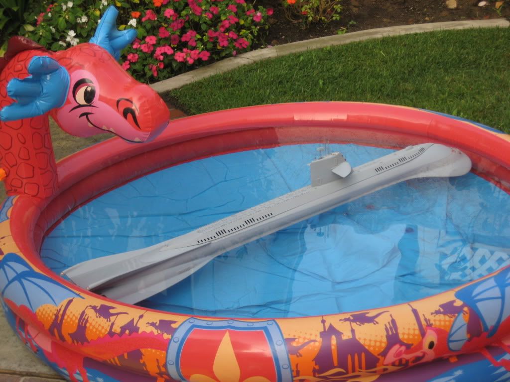

Trimming Seaview in the backyard kiddie pool happily donated to the cause by Houston buddy Paul Crozier. This brief effort occurred literally minutes before loading her in the car (still dripping wet) and hopping on the 5 Fwy. north toward San Francisco, Friday morning, September 30th.
Honestly, don'tcha just love this trim tank though? It's the perfect "Voyage" adventure—Seaview takes on the giant (happy!) dragon, and with no means of escape!

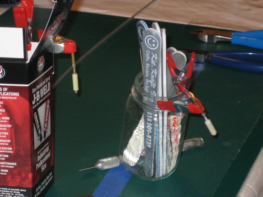

Reworking the LED connection points to the access panel for the under-keel manta fin lights. The brushed-on JB Weld (yes, I admit I'm hooked on the stuff) is to strengthen the panel overall and help it retain its shape—which tends to warp/flatten out over time. (The piece was bound into shape with rubber bands while the JB Weld cured, if you must know.)

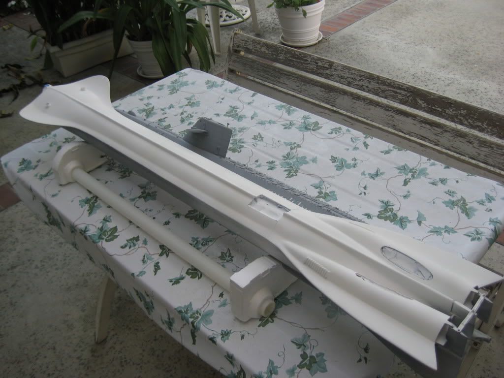

Postby JefftyToo » Sat Sep 08, 2012 12:54 am
Here's the latest...
Filler work begins on the aft hull joint.
Aye, thar be porthole "glass" now!
The file folder spines JB-Welded into the hull worked out only partially as planned. Fixing the aft hull joint has now become a Big Deal. Ugh.
