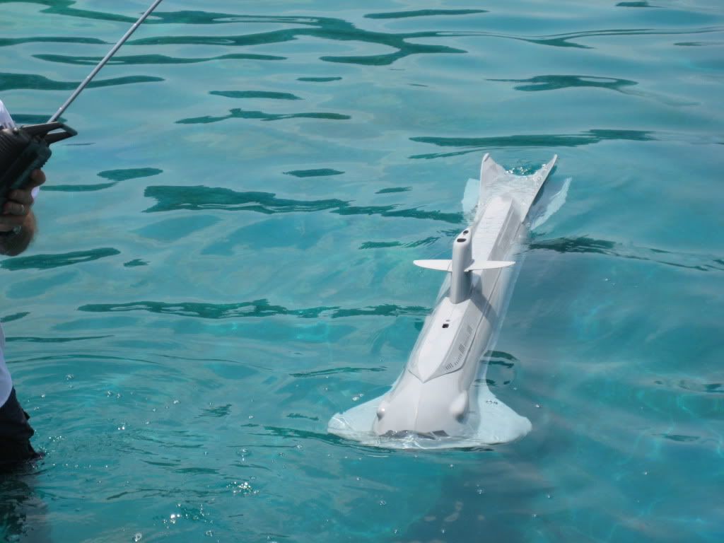

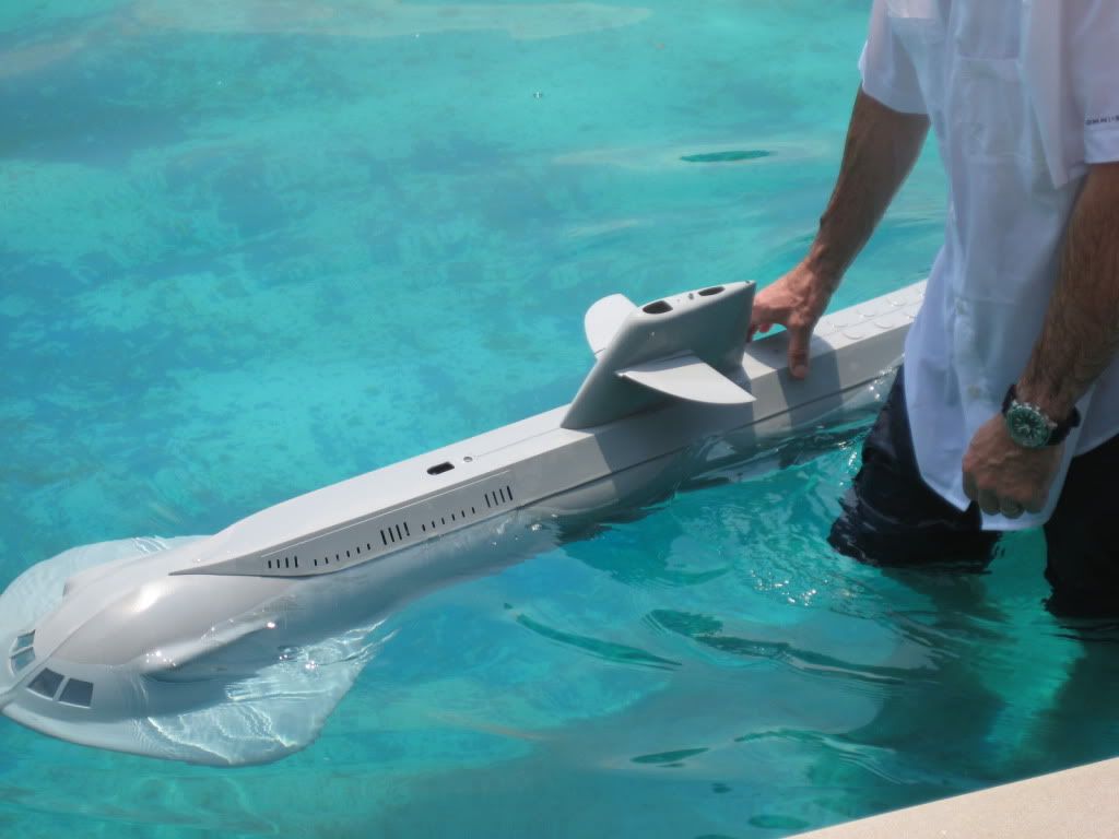

Postby SteveNeill » Fri Jul 08, 2011 6:40 pm
Rick sorry about the name people do it to me all the time too.
No I have built His, Polars lights(2) and now yours. They are all the same. Full throttle they jack up their rears hight out of the water and the nose goes down.
Deflector can help but I did use them on yours. The reversed sail planes and the APC made it nice and smooth as long as you don't horse on the elevator. Best to set a bit of up trim. Hand off the dive planes. Blow ballast and move forward slowly. She will dive level on her own. I learned this from the Polar lights version I still have.
Now for some reason the Dennis's 57 inch seem to plow a bit more. The deflectors helped but them again I did have the sail planes reversed. That might be it.
Jeff pointed out to me I forgot one thing. I did remove the masking on the sails windows! Doh!
Thanks Rick. Get building. I want one of these down the road but I'm still trying to get my CR 66 inch Nautilus finished. Great boat you did!

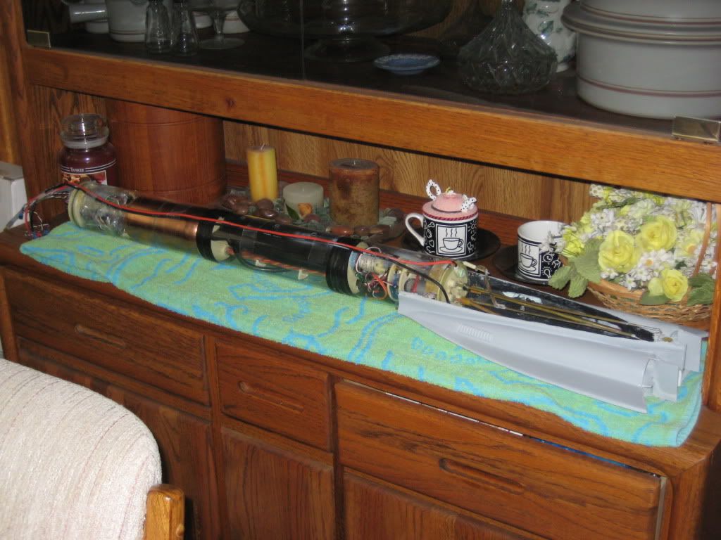

And Kerry here's the picture of the holes. And the unique way Jeff came up with for putting this boat together eliminating the seams running the length of the boat's hull.
Steve
angle and slide...slowly and check
Slide some more and check and pull the battery wires forward.
Be sure not to snag up the control horn to the sail planes Jeff! ;)
Slide and check some more.
Done.
Fits nice.

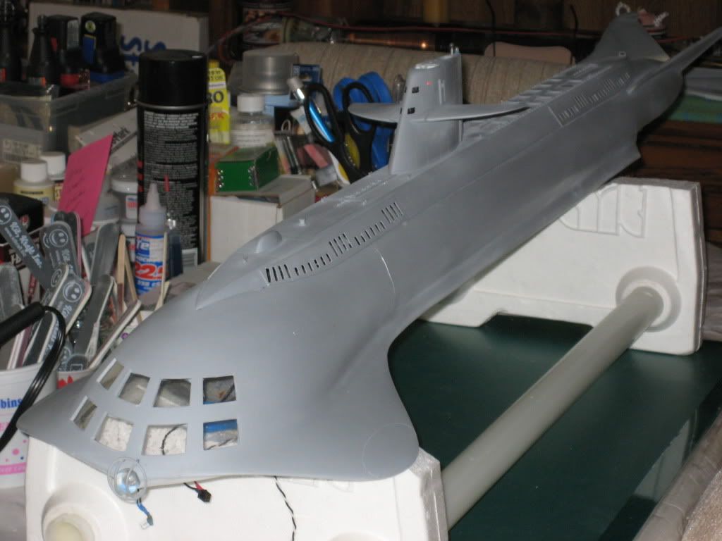

So now work begins on a major Seaview refit, with my new goal being to have her repaired, re-trimmed and running again in time for Shakedown Cruise No. 2 at the annual SanFran Fall Fun Run (October 1-2). There's so much to redo and retest, however, I've no guarantee I'll make it. But I'll post some photos of my efforts along the way, starting with these few below. Enjoy.

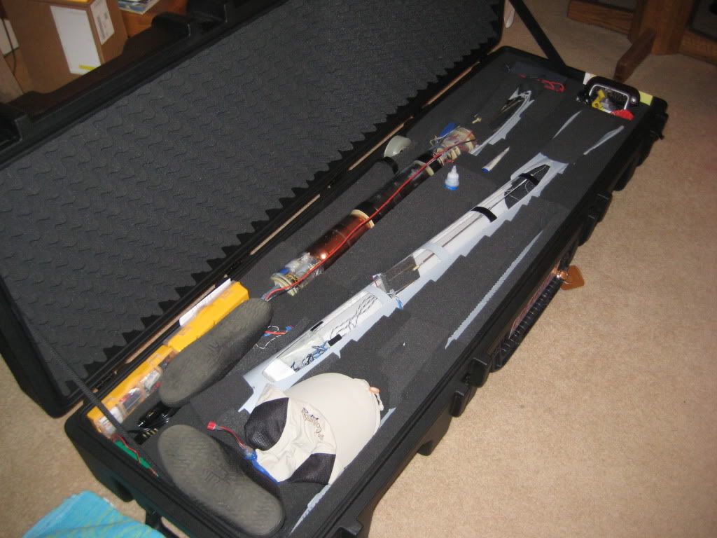

Here's the big case, all boat-packed before the trip.

Back at Seaview all day yesterday. Problems continue: split hull repairs not going well, a lighting short, more cosmetic damage as I work to make the WTC easier and safer to install and remove. Will definitely be switching to cable linkage instead of a metal rod to control the sail planes; the mount for the tube to support the rod simply descended too far down into the hull for the WTC to slip past without "issues." Overall, the repair list is now getting longer instead of shorter, but I'm sticking with it. A few pics:
Reshaping the stern for a better fit.
More filler/paint/primer cracking requiring repair.
Some success: worked long and hard to achieve a better fit for the keel-mounted access panel for the Observation Room. Almost there: some filler and touch-up painting still to go.
