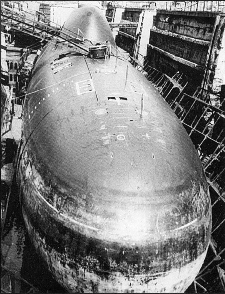

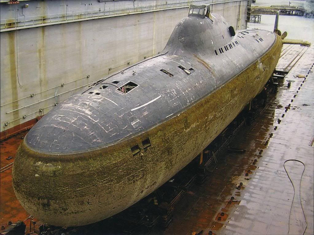

Thanks redboat! to be honest with you, i took a good long look at my plans and these two photographs
and i drew them out in pencil multiple times until i got the shape to match the photographs. then i marked them in sharpie and scribed them. sorry, i didnt take photos of that process.... as for costs so far, i might have $70-80 dollars in this between the bondo, fiberglass and foam plug. i thought of going 1/96th, but i felt like the hull would be too small inside for what i wanted to do with this sub. even in 1/72nd scale, it seems cramped compared to that monster IXD2 im building.

Re: 1/72nd scale alfa class ssn
Postby redboat219 » Wed Mar 02, 2011 10:26 pm
That's one crusty alfa :-D
Anyway, did you you use a template to help in scribing or did you do it freehand?

Postby the dark knight » Thu Mar 03, 2011 11:08 am
she is a little crusty isnt she? :lol: i free handed it. if you look close i didnt get them to perfectly match one another. looking back, i wish i had made a template. i still could i suppose, for V2. ill let you know how it turns out and ill post it up if it works!
