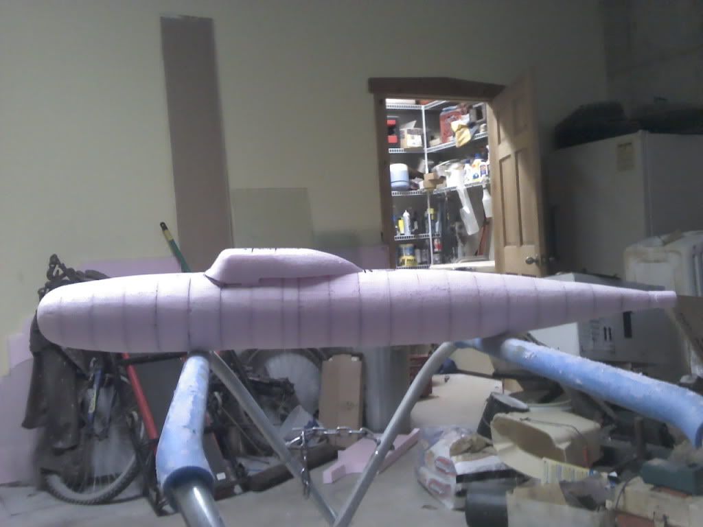

well, i decided to avoid confusion, i would break alfa into her own thread. so far so good! just have the bow left, and the first layer of glass will be done. whew.
lets start from the beganing.... started off with the left over 2' foam from my IXD2. cut it out on my band saw, and shaped it with a wood rasp and 60 grit sand paper
then shaping begain

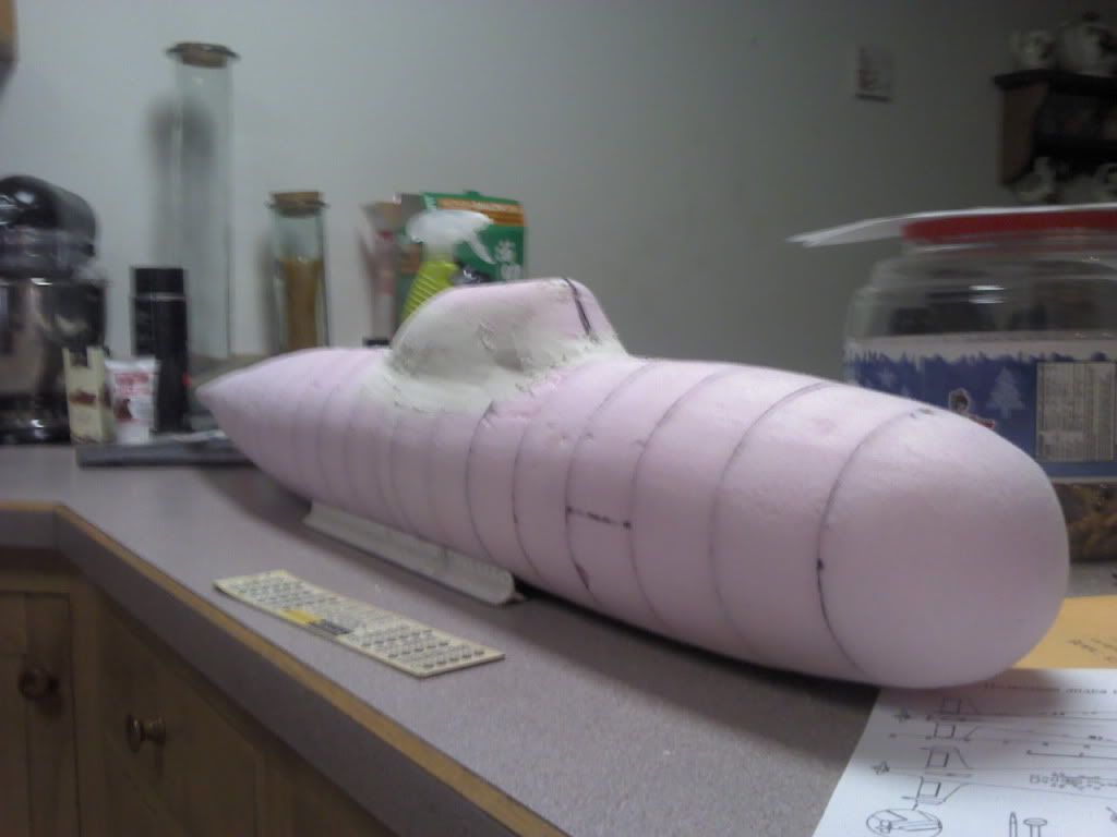

then i looked at the plans and photos, relized the alfa has a small ledge around the tower in the rear... so i dug out my drywall compound and begain shaping that

so i decided on this one to try the duct tape method of sealing off the plug
it sort of worked, the fiberglass is causing wrinkles in the tape... not a big deal, not any major distortions yet. so i started at the conning tower and fiberglassed it first
then turned it over, and glassed her belly and stern
thats where she stands now..... next is the bow!
