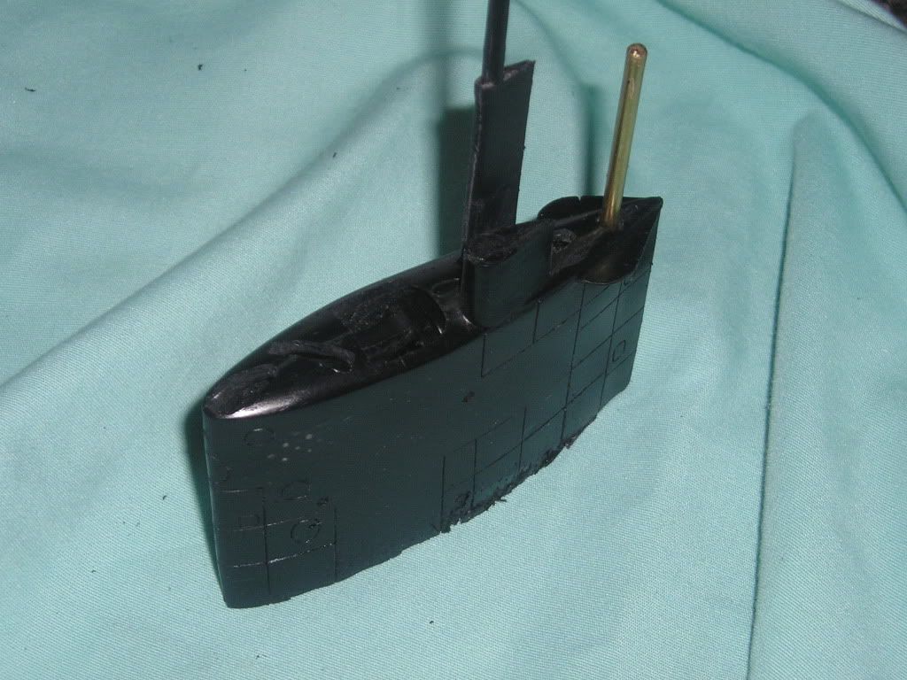

Hi Guys,
A quick update here on where I am with the Jack.
All the moulds have been completed and I am now making my own personal boat for extensive testing performance measuring, and manual photos. Take note that the boat isn’t painted yet, it’s all in my pigmented epoxy layup and surface coat. Now people can do their pre-painted test runs in style! Some other notes; the scope rack has worked out quite well although it still needs minor trimming to properly align the scopes inside the sail still. I can live with that that however. The gearbox has passed initial trials for function and installed quite easily into the back of the boat. This too needed minor modifications from my initial setup to move the assembly further to the back of the boat in order to get the wtc ballast tank more centered.

Ok,
Here is where we stand now. She is ready for body work, paint and fancy, shiny aesthetics.
