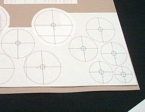

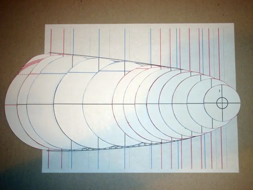

I started with the 2D plans and developed cross sections that would match the 9/16" and 1-1/2" thick construction styrofoam that I had, and is the easiest sizes to get. In the photos the blue is 9/16 and the pink is 1-1/2.
Here you see my first mistake. Because the foam body of the master will be coated with plaster, and eventually a epoxy resin and glass shell, these cross sections don't account for the added thickness. So I drew circles 1/16" inside the actual exterior circles and printed them out and pated them down. Steve Neill says he uses old cereal boxes for a cardboard to paste them on to. Well, I don't eat enough cereal, so I got some thin gray chip board form my local art supply store to use.

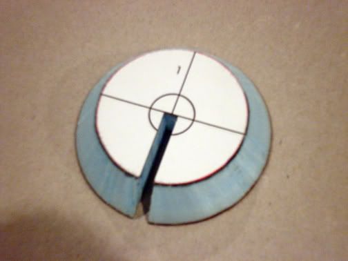

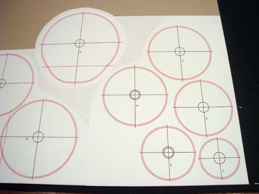

The next step is to cut all of these out. They will be used to sandwich a piece of styrofoam between, with each side registered to the other. Then they become cutting guides for the hull contour. You'll see later.

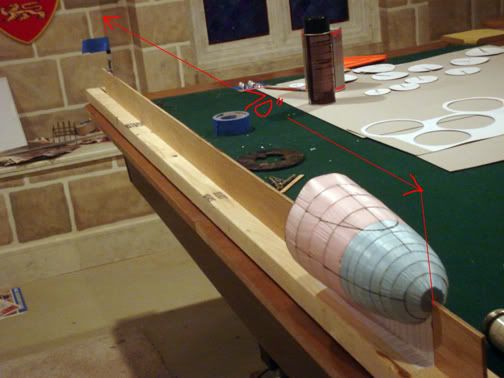

After cutting out the cross sections, I then cut a slot up the center of each the width of the spineboard I am using. This slot goes up to the center line on each, and by that resting on the top of the spineboard every piece will be registered to one another. I then coated the edge of each with super glue to make them hard. Then the foam cutting wire will be able to travel over the edges without burning or cutting them.

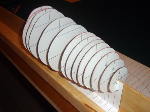

Here they are lined up on the spineboard. I Super77'd a plan profile to the side of the spineboard which shows me where each section should go for a guide.

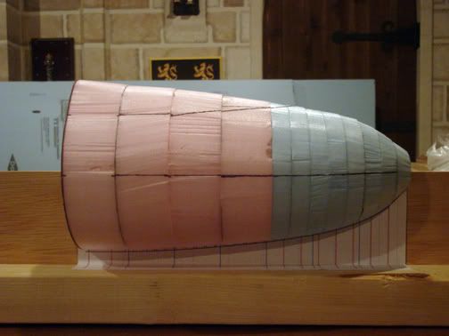

From a 3/4 angle, you can start to see what the 3D piece will look like. And you can even kind of check your work at this point. If something is dramatically wrong, like a cross section is missing, you'll see it here and hopefully save some cutting and frustration.

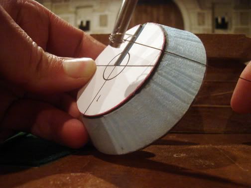

For the foam sandwiches I glued one cross section to one side of the foam. Then on a bandsaw (because that's easiest) I cut out the slot for the spineboard. The I glued (Super77) the next cross section in the sequence to the other side of the foam by lining up the slots. With a hot wire knife against the edges of both sides you can cut the foam center to a straight-line contour of each section. I take the cross-section templates off each foam piece once they're cut by using rubber cement thinner to unstick the Super 77.
Once all the sections are cut, they can be assembled on the spineboard in order, checked with the plan underneath, then Super 77'd to one another.

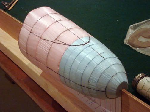

Here you can see them together, now really beginning to take on the distinctive shape of the Ohio bow with the missile deck beginning.
With a little light sanding from one of those sponge sanfing blocks, the shape can be further refined. Don't sand away all the high edges, they'll be used to determine the depthe of the plaster coating later.

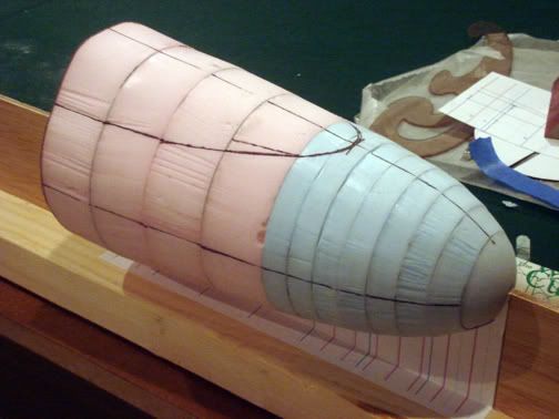

So far I've only got the bow back to where the missile deck fairwaters begin done. In this photo I give you an idea of how big this sucker will be. Ain't it perty?

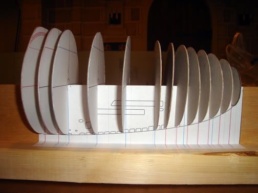

I finished all of the chip board cross-sections, cut the remaining foam pieces and glued them up on the spine board. This is one long S.O.B.
Here you can see again on the stern, as it did on the bow, how the plan pasted to the spine board with my cross-section lines helped to make sure things were lining up and coming out to the correct length. The gap between the edge of the foam and the outer margin of the hull will be filled by layers of plaster and fiberglass.
With each successive piece of foam cross-section cut, I transferred the axis lines from my plan, which was glued to each chip-board cross section template, to the foam. Then, once they were glued together I connected the dots with a straight-edge to get very accurate vertical and horizontal planes.
Here you can see how the spine board keeps everything nicely inline, as long as your spine board is straight. The numbers for each cross-section are listed on each piece, as well as on the plan pasted to the spine board. That sure helps keep things simple.
