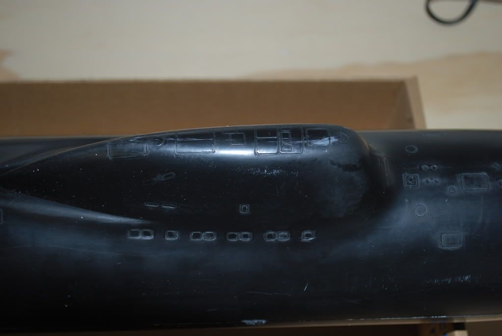

Hey Guy, you may have seen my post a while back asking about alfa hulls. Well I decided to go with the scale shipyards hull because it was the easiest for me to obtain.
Here she is:
The scribing detail on the hull is pretty good:
The hull came with a few scratches and a small piece of fiberglass missing on the tail. Nothing we can't fix though.
Here are the: bow-planes, bottom rudder, and aft planes
She's almost about the same size as my out of scale Dumas Akula :roll:
I started by first opening up the vent holes on the bottom. (I will come back and neaten these up with a file later on)
I'm thinking of running a caswell generic 2.5 WTC in her, which fits pretty well. If anyone has any suggestions on anything that I should do to improve my build, I'd love to hear about them.

Postby Phin » Mon May 18, 2009 8:03 pm
Thanks for the positive support guys. I too think that the alfa is one beautiful ship, it's got great lines.
I finished opening up and cleaning up the vent holes on the bottom of the hull today.

Postby Phin » Fri May 22, 2009 10:29 pm
No problem Sputnikk, like you I am also pretty new to the sub hobby and the more info we newbs can get the better. I've been told that Dave Meriman's 1/96 Skipjack prop fits this model perfectly so that's what I'm looking at right now. Also I would recommend getting Nuke Power's fitting kit upgrade, which really helps this model. Also I'm going to be using a 2.5 Sub-driver from Caswell.
Fittings
Sub-Driver
Ok, so progress! I finished opening up all the holes I need for the sub to vent right.
