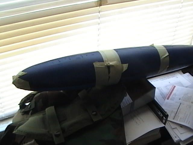

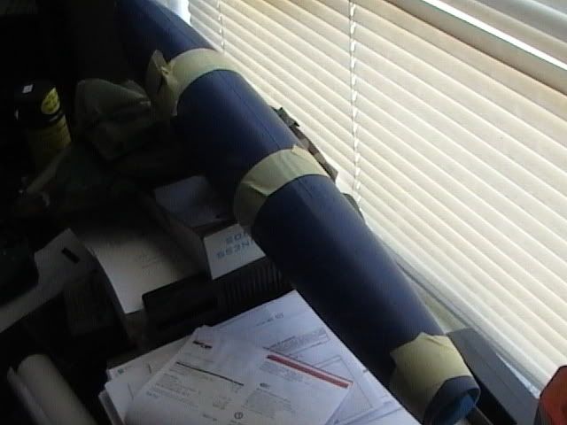

I am looking to ask you guy's out their with General Data and photo documentation for the George Washington Class Submarine to be posted here, or sent to me on Disk. I have been giving a Skipjack hull by David Merriman to build one for myself or as a kit later. This will be in 1/96th scale, and Dave has offered up a folder on the subject that will be of great use to me.
I still like to ask for any help you guy’s can give, in the photo you see what I am starting out with, a Great base to work from, should be 100’ section added to the center of the boat, then a Missile Deck, New Sail & control surfaces, simple right? But just another boat that I have a interest in and hope you guy’s can help out with as time go’s buy.

Very good this is what I need to know, I'm a sucker for the detail Ivan! I herd 130' v 100' section to make the boat longer, Dave hs all the info I'm sure but more One gathers for all sources can help with the final build. Photos tell a thousand tales for me and these two are new for me!
