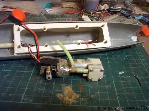

petn7 wrote:The smallest airpump I know of won't hold a seal. I could probably make this a static diver by using a forward only ESC, lithium battery pack, and a few other "shrinking" measures, to make room for the airpump and tubing, but maybe I'll do that later.
For now, I want more room for a bigger battery and a pitch leveler.
Well done sir
I got this model too
After looking at your ALFA maybe I should stare my project too
by the way you should try this one
a mini air pump that I used it in my 1/144 Romeo class
Xin
http://www.evermotor.com.tw/950828/JSH10-D.GIF
